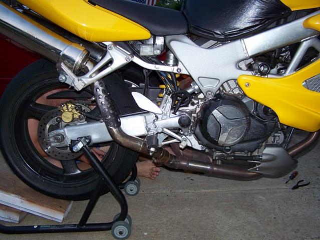

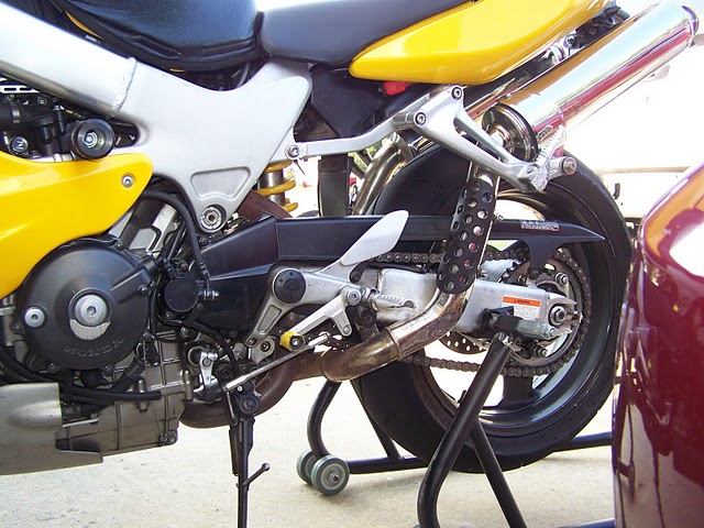

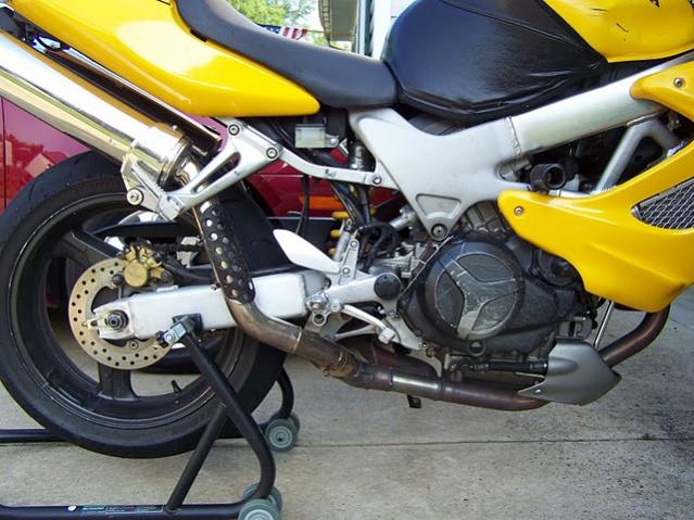

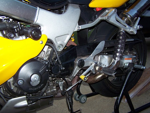

Update on my progress with lowering the pegs. For those not familiar, you can do a search on the forum for the idea, but the general concept is to buy some pre-2000 kawasaki ZX9 footpegs and bolt them onto the exhaust mounts on the footpeg bracket.
These pictures are not very good to see the actual difference.
One issue I have noticed is with the shift lever. Lowering it to align to my foot position presented a problem with the back of it hitting against the ZX9 footpeg bracket.
The second thing I noticed is the size of the ZX9 pegs I got. The right was from a 93 model and the left from a 98 model. The 98 model is smaller and I like it much better. If I stick with this setup, I'll update the right one to match.
I'm going to ride some and make a decision, but may swap back if I'm not comfortable with the shifter. However, from a comfort perspective, it makes a big difference on knee bend.
Attached Thumbnails Cheap Peg Lowering-pegs-right-before.jpg   Cheap Peg Lowering-pegs-right-after.jpg   Cheap Peg Lowering-pegs-left-before.jpg   Cheap Peg Lowering-pegs-left-after.jpg
