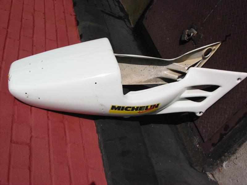

Yeah, its gonna be like twice as wide, I guess thats the "super" part they added. I can get you the measurements tomorrow, my SH doesnt live with me. Are you going to do a solo seat or carry a passenger? I ask because I have this cbr race tail that might fit better....
Attached Thumbnails can somebody help me out with a measurement-cbrtail-015.jpg
i'm actually waiting on another tail that is coming for the hawk but thanks for the offer. the superhawk tail idea was floating around after someone put an RC51 tail on a hawk. so i know its gonna be wide, but how much is the issue. the rc tail looked ok, i was hoping the same for the superhawk.
