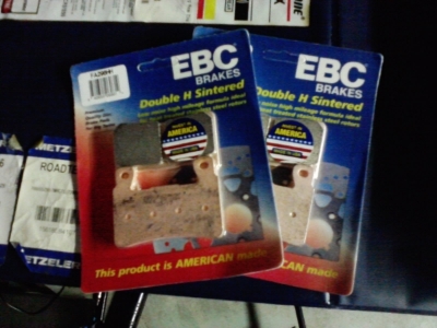

Joe hit the nail right on the head. Follow that advice and if you are still unsatisfied, rethink the swap to the F4i brakes. They can be had for cheap on ebay and make a huge improvement.
This season I did the swap and installed a set of these:
Excellent pads IMHO.
And welcome to the forum!
