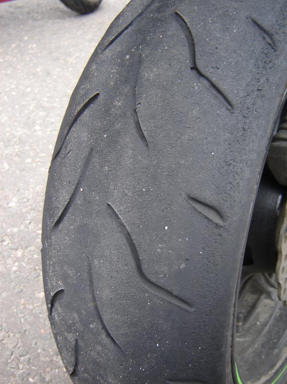

back tire life, haha
so ive read on here that our bikes are hard on the back tire. i thought to myself really how bad can they be. i run it at 28 psi cold because it grips better so i knew id sacrifice tire life. im running bt016s im under 2000 km and almost at tread wear bars. i figure first gear power wheelies and 2nd and 3rd gear clutch up practice likely caused this. i was starting to feel like the bikes clutch was slipping in first and on he occasional clutch up when the front would barely lift but now im wondering if its infact the rear tire breaking traction. oh well i love this bitch

wow! you did a hell of a job on that tire. Your old lady finds out about that and you're in for it boy. haha You will be lucky to get another thousand on it before you do your celebratory goodbye burnout, huh. Between the torque and the engine braking, we need hard centers. I was running 28psi also(present Q2),which when warmed up becomes 32-33, but have since gone to 34 cold for that very reason. Still grips well albeit a little rougher riding, but got used to it. 28-30 front is fine for me: grips well and wears well, but will go with rear. Power Pures are waiting patiently in the garage.

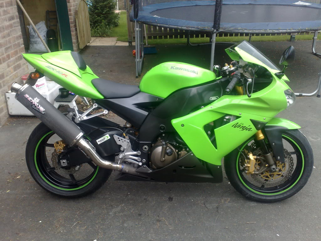

Sp1, bt 016 800miles on the rear 1200 miles on the front
2005 zx10r 600 miles on the rear 780 miles on the front tyre
hence too say i have sold these and run a firestorm to calm me down and save on the tyres
also i only run stock temps IE. 36 front and 42 rear, on the road no one can tell the difference, only thing i found that on the road the zx10r would spin out of every corner when piping hot, but the bike never tried to spit me off
Ill post the pictures of my tyres if i can find them

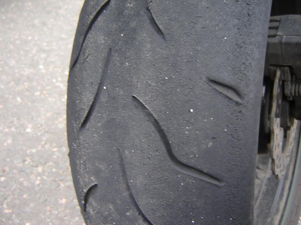

Tyre pressures on the road dont really make jack ****, i have been down to 29 rear and 31 front, i found the tyre could not keep it shape and had uneven wear...
some people will say that the wet grip changes.... really.. just back the compression and rebound off 2 clicks if its wet
and the zx10r would spin it on the rim!! im not the fastest but i aint slow, if you run street only run 36/42
but if you are running race tyres on the road.. say Michelin power one i would say run 32rear and 30 front cos of the make up of the tyres
Im obsessed with tyres and suspension and how they react
Like you can get two identical bikes from the factory and the setting on the forks and shock will be different for each bike for your weight

Nice tire. My rear looks similar to that just not as bad :-)
Are you refering to front or read suspension? I have the factory rear shock and as far as I know it has no adjustments.
I ran 42 rear in my old bt 021 st and the bikes rear would come out regularly in corners. I'm gonna bump my rear to 32 cold just to give it a bit more life :-)
Nath. Shes gonna be pissed lol this tire has been on the bike less than 2 months. Lol. Guess that's a little less money I save for our wedding. I'll be sure to get the Burnout video on tape. Is like to get this bitch down to belts and get some sparks :-)
