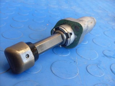

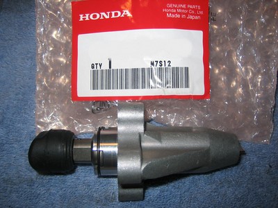

The latest version of the CCT looks like it will hold up better than the previous version. The end of the tensioner is now rubber. I imagine that will translate into a lot less abrupt shock to the "teeth" on the tensioner itself, reducing failures. The CCT's that came out of my 2005 still had the steel end on them, so I'm not quite sure when they came out with this new & improved version.
OLD - - - - - - - - - NEW
Attached Thumbnails Attn all VTR1000 riders-old.jpg   Attn all VTR1000 riders-new.jpg
Old Mar 17, 2009 | 10:07 AM
NEW - - - - - - - - - OLD
Those are for a VFR, not a VTR..
Type that part # 14520-mcw-003 in here: http://fiche.ronayers.com/Index.cfm/Module/WhereUsed
