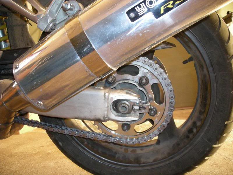

I really like the 44T rear sprocket upgrade. More grunt!

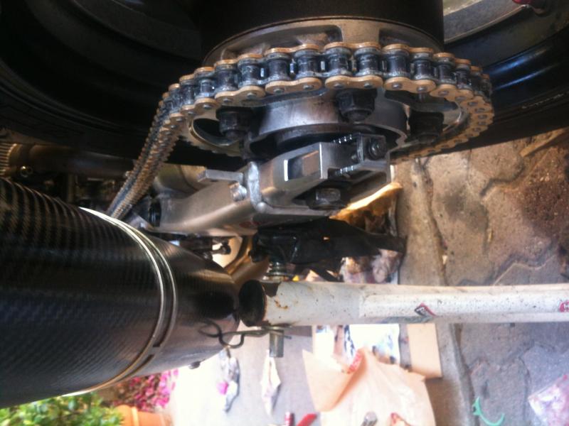

a pic...or it didn't happen, right?
