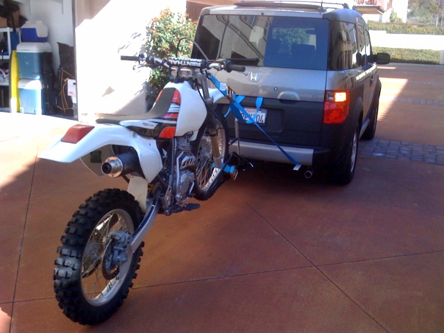

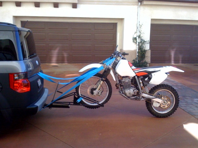

So I got the tilting/crank up tow rig and promptly used to go buy and tow an XR250 home. Scored the '99 XR250 for $1150 in great condition. The tow rig is super easy to use for one person. I towed (trailed?) the bike for about 10 miles. I stayed off the freeway. Bike was fine.

I used it with Superhawk recently for a short 15 mile tow, and it worked fine but it makes you nervous as the bike counter-leans in corners. Also the cradle of the tow bar almost makes contact with front rotors when its all straped down. So I kept thinking about possible damage to the rotors while the bike is leaning in corners. But the rotors were fine. Also I stopped a few times to start the hawk up and make sure the gearbox got some fresh oil. I felt much better using it with the dirt bike.
Bottom line is it great for those that don't have the space for a trailer and need to pick up a bike right away if it's broken down or wrecked. Or to take it into a shop, from a buddys house, etc.
For track days I would go the rental route. an MC trailer from Uhaul is only ~$15 a day. And you would not be taking any meat off your track tires like you would with this thing. I use a Uhaul to take my dirt bikes out with my son.

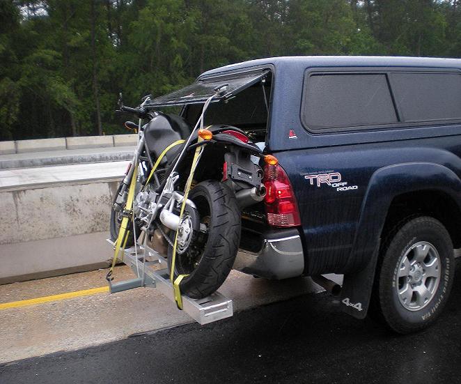

I saw this the other day!

Yeah those are great if you can take that much tongue weight. Most cars can't; Only trucks usually can. Which begs the question...why not put it in the bed?

yeah im doing a car deal, cant do tongue weight and obviously i dont have a bed :P
