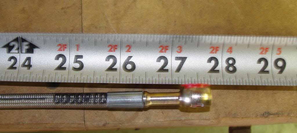

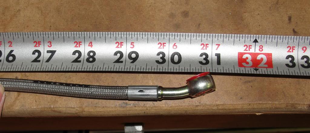

And the measurements. First pic is side by side.

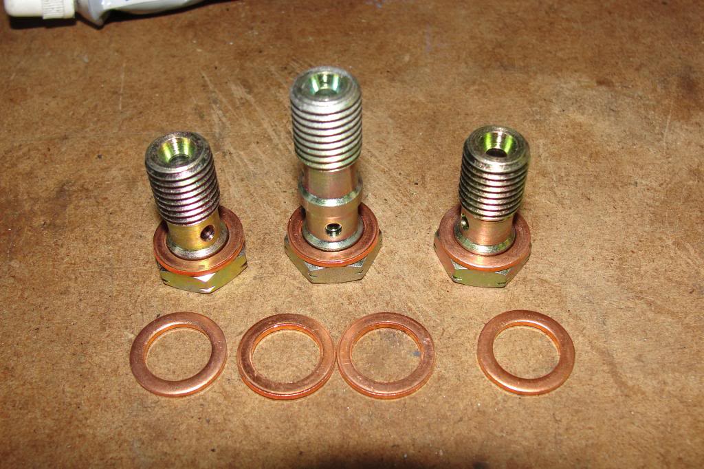

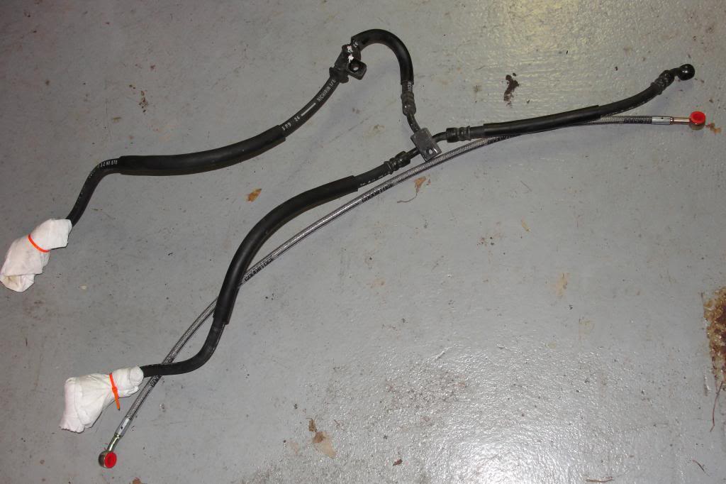

What else is in the box (BTW all are 14mm):

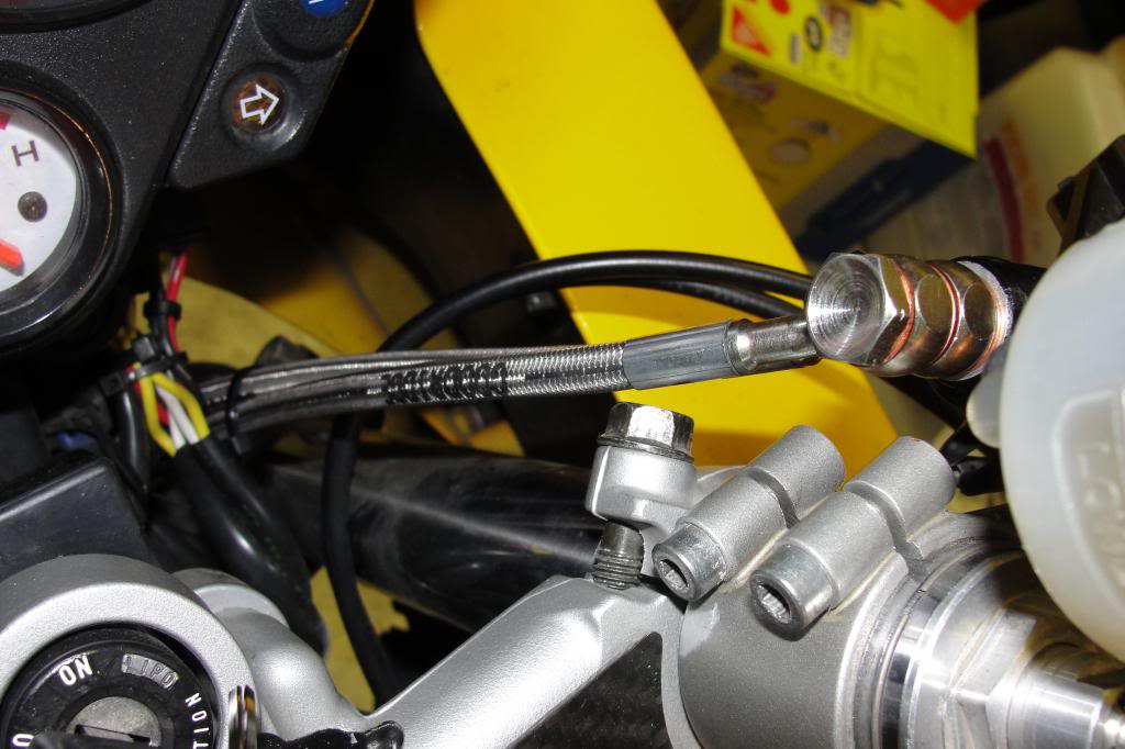

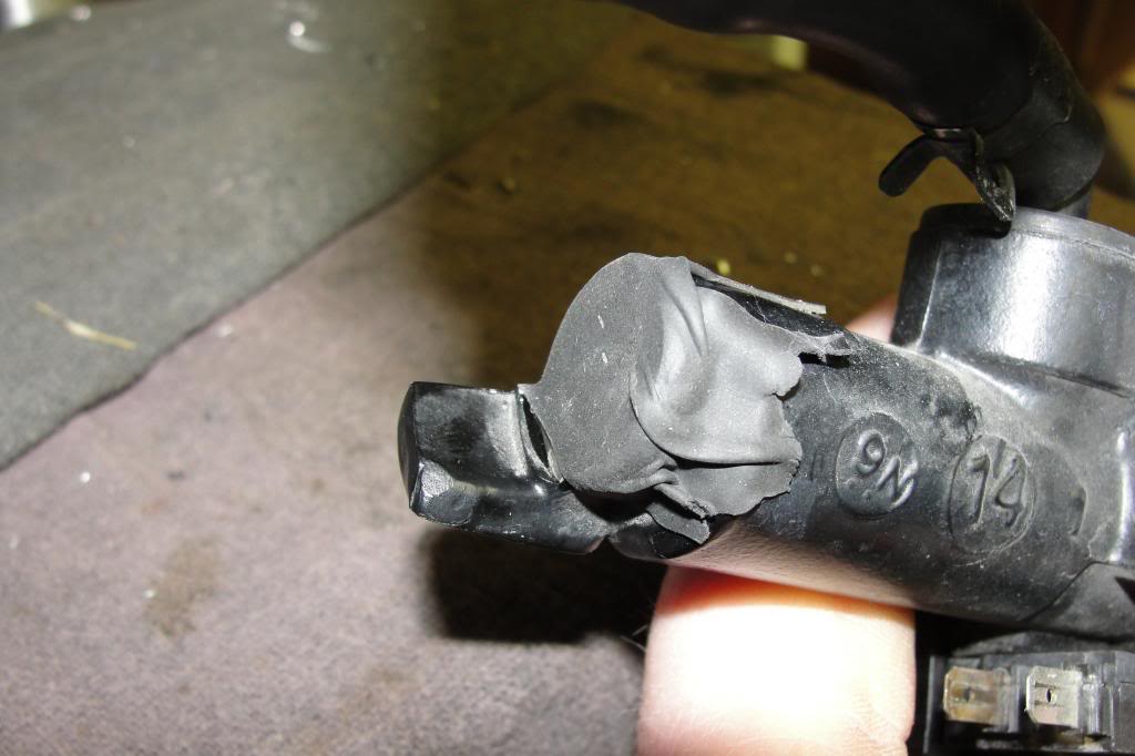

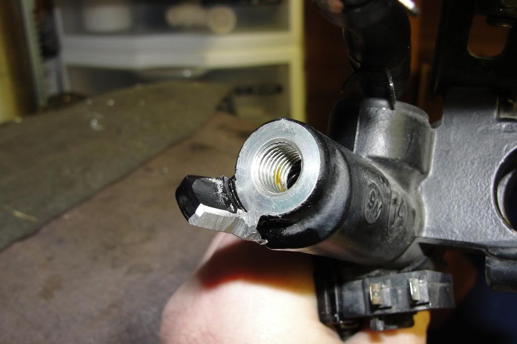

Check out this guys page. I found I didn't like the way these angled with the anti rotation tab of the master cylinder. So I ground a little off:

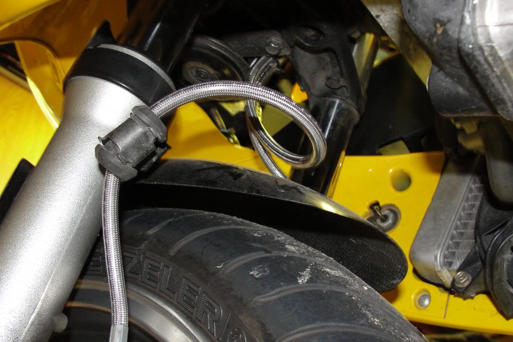

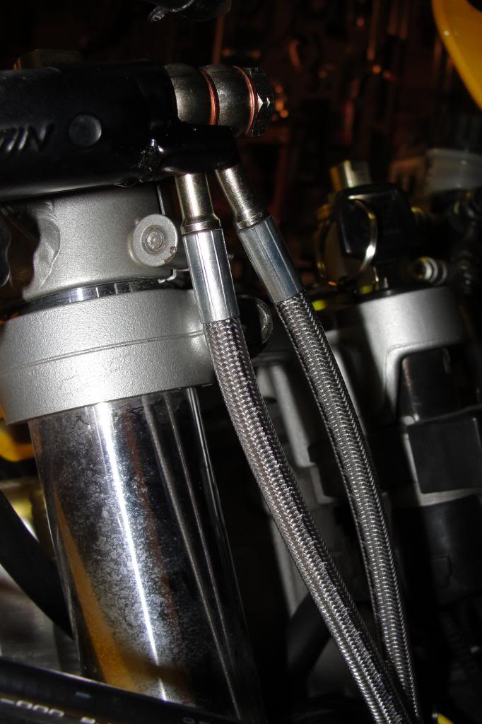

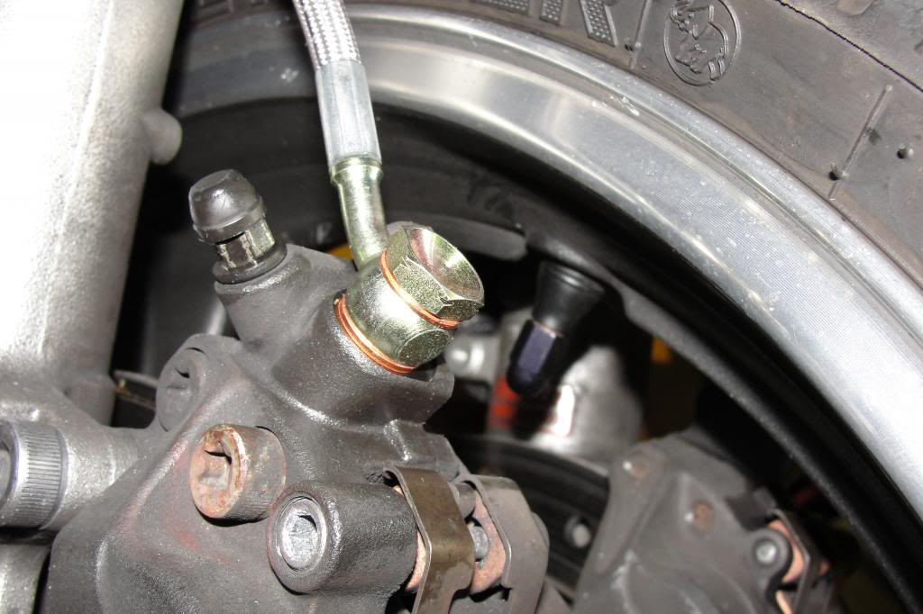

And the fit:
Haven't ridden the bike yet, but I'm sure of the results. Like I said, I've done stainless lines before and I'm aware the benefits, just never got around to getting them for the Hawk. $65 and change isn't bad for NIB.

It appears the banjo bolts are cadmium plated carbon steel rather than stainless steel (CRES), correct?
