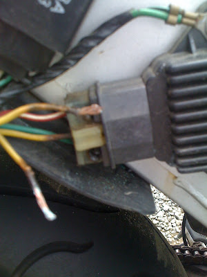

Old May 31, 2009 | 11:40 AM
Erik S.'s Avatar
Posts: 1,216
From: Westerly, RI
Old Jun 1, 2009 | 07:48 PM
Circuit_Burner's Avatar
guru of things sparky
Posts: 599
From: Grand Prairie , Texas
The three bottom leads are the AC from the stator.
It is usually like this when an overcharging situation is taking place. (R/R failure mode B)
In this situation it damages the battery internally, resulting in exactly what you described.
you will likely need a new battery, along with a R/R.
Ditch the plug too as those AC leads at the terminals are a heat source.
Youve probably seen my offerings, they come plugless unless specified otherwise.
Theres a story about why the regulator plugs get so hot, but thats not for here.

Old Jun 2, 2009 | 02:27 PM
Erik S.'s Avatar
Posts: 1,216
From: Westerly, RI
Page is starting to look good.
I've got an R1/R6 on the way.
Thanks for the heads up on the battery. Is there a way to check for a dead cell. It's showing 12V right now after being on the battery tender.
