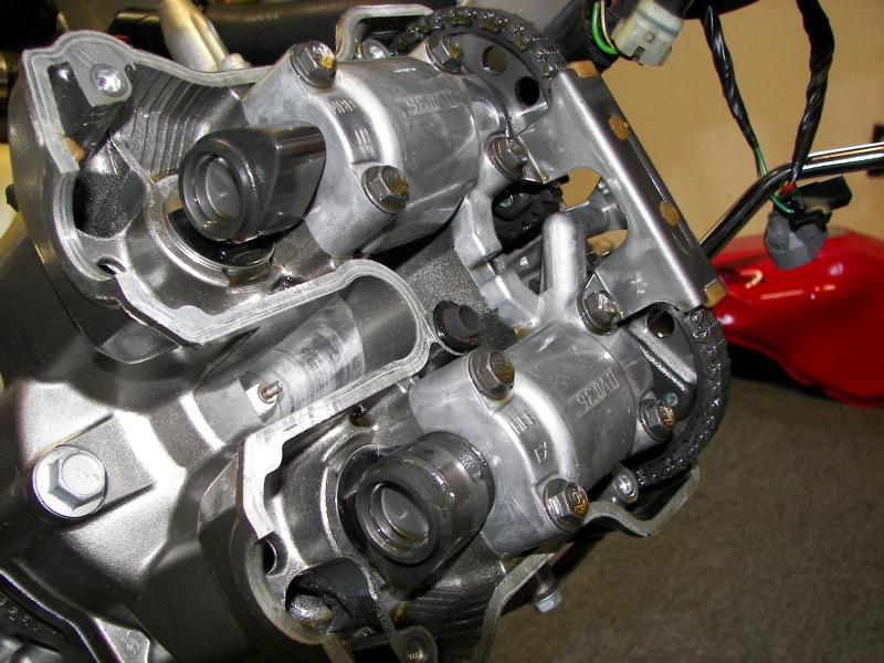

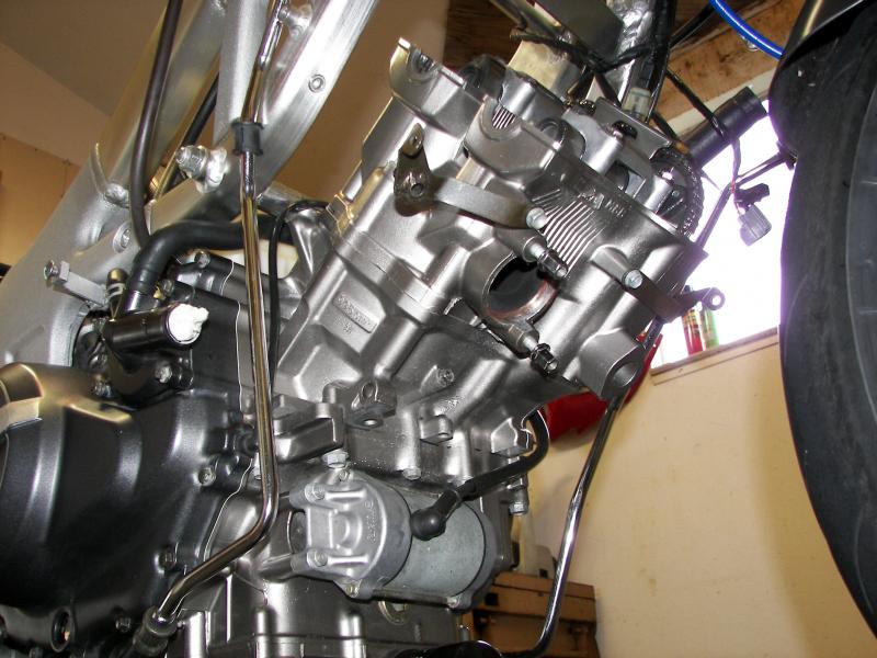

KCCO, call me confused... I do not understand how flipping the reed / stopper is beneficial??? Perhaps I am just misunderstanding your procedure? It seems to me, in it's original position the reed allows air in under the brief negative pulse in the exhaust port and conversely keeps the positive pressure from escaping through the reed, and exiting down the header as it should. I imagine the positive wave would be much more than that of the negative / vacuum wave. Either I'm missing something or what you prescribe is the reverse of what is to be accomplished? With that in mind my fittings have been plugged for years until I get around to removing the hole mess for block-off plates!
I'm not asking this in an attempt to bust *****...just looking for something I missing?
My apologies to all... as this discussion should most likely take place on a different thread

Yeah.......So??? I still do not get it! The reeds don't even need to be there!!!!!!
Once the vacuum is gone to the valve covers (block-off plates or what ever.... which is all too easy to do)...what's left????
Positive Waves!!! <<<<<<<correct.................................. .?
What happens to the + pos. waves...coming up the air passage from the exhaust ports... after the o-ring in the valve cover fails?
My guess is, some immeasurable amounts of pos, and neg. waves go through the valve covers and into the "stock air box"...
Making an already (tough-tune) set-up, just a bit more ponderous???
To me, the question is....I want to find the best way to plug the (Pair passages) @ the exhaust ports???
Seems like some may be under thinking this backside thought?
