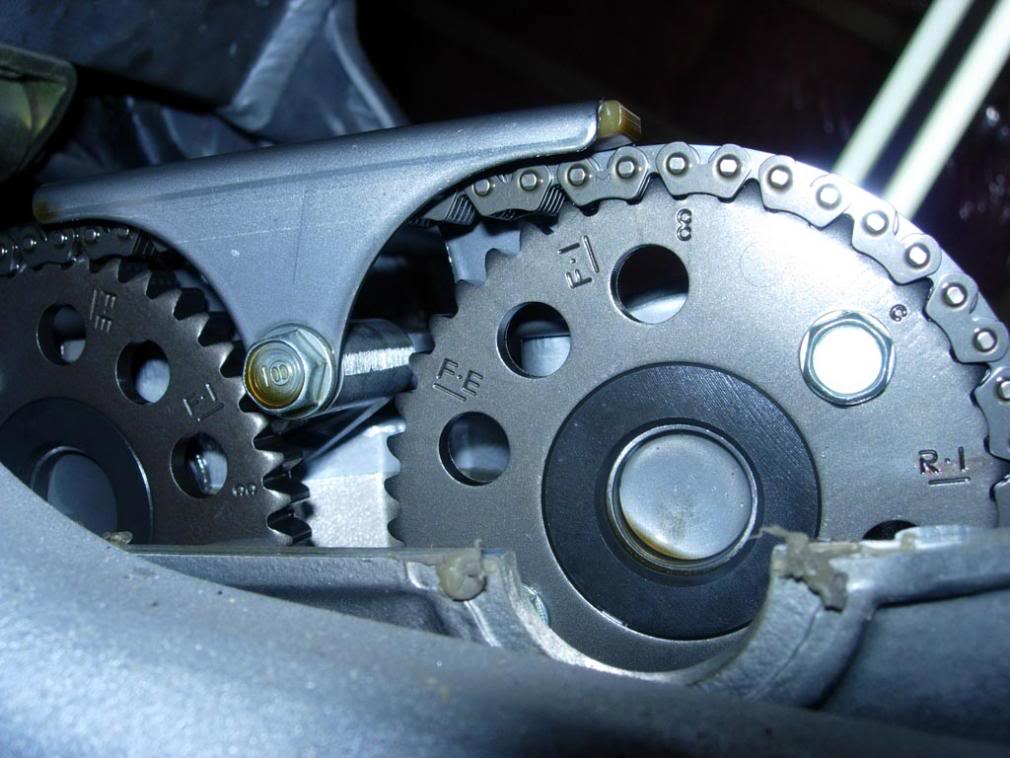

Align the flywheel mark RT to the dot in the stator window and the rear should look like this.
On the front cyl, use the FT crank mark and the FI &FE marks and align to the edges of the cam cover seat surface.
There should be a 270° counter clockwise rotation (stator side) from the RT mark (cam aligned lobes up) to FT mark (cam aligned lobes up)
If this all checks ok it should start.
And yes remove that other cyl plug while testing, it will avoid pumping gas and messing the cranking speed.
