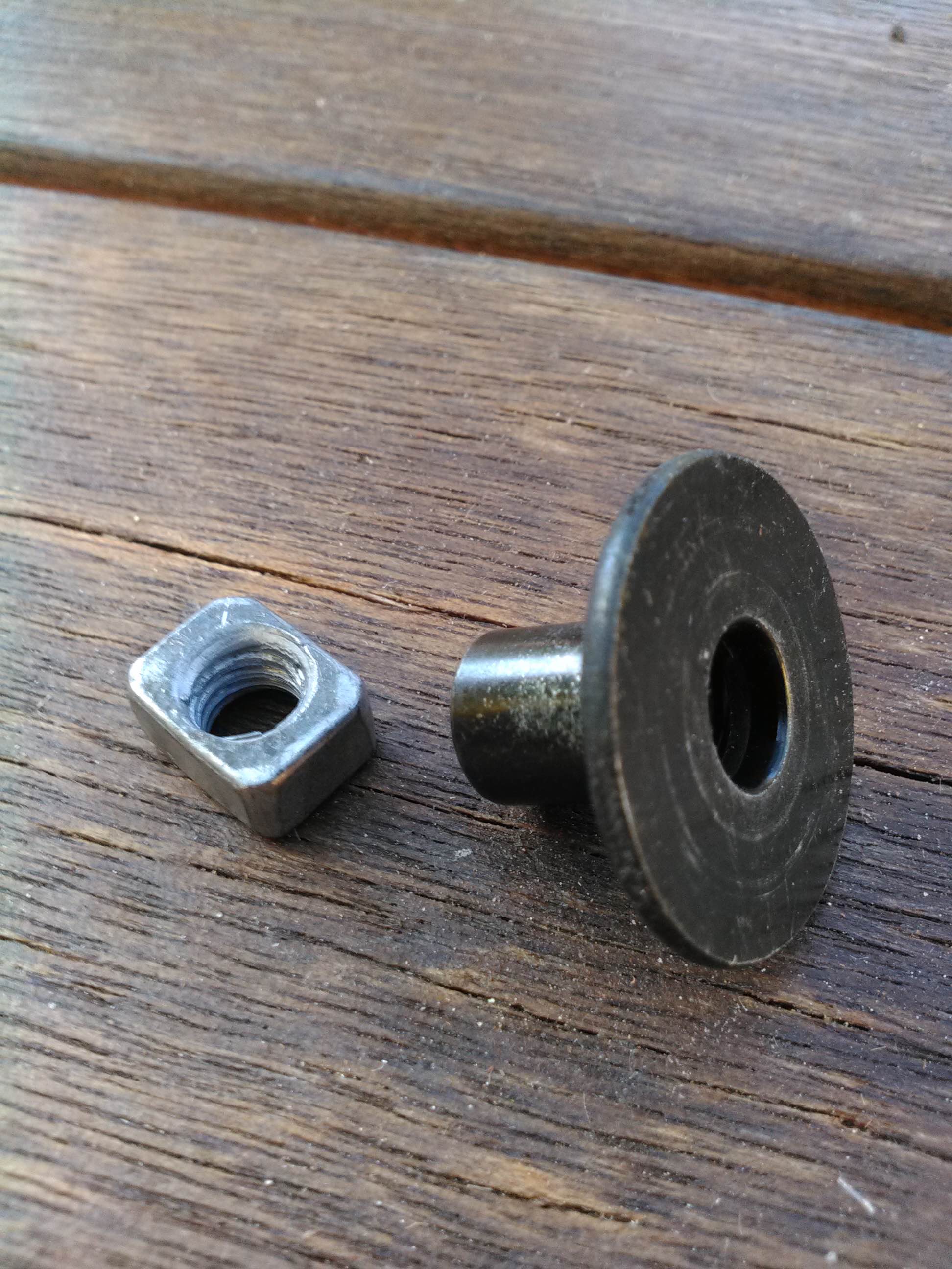

Ok I took off the rear cowling, fuel tank, air box and air filter and these bits ended up on floor- two of the washer and one nut. Where do they go????

22 Collar
https://www.bike-parts-honda.com/pie...IRE+STORM.html

Could be mistaken but that one piece looks like the fuel tank bushing. Other one is over my head.
Old Feb 24, 2017 | 05:25 AM
The square nut looks like a battery nut. I've dropped many over the years.

Steel collar is either fuel tank rubber spacer or dash rubber spacer.
The rectangle nut appears to be for a batter terminal.

Wopverene good call! It looked different on my chinesiim screen but I zoomed in. Thumbs up. You know where that bushing goes right? Pop it in the gas tank where the rear 10 mk bolt goes through. It acts as a spacer and guard against the bolt eating up the rubber. Your tank is probably sitting a slight **** to one side. Thatll even it up. I forget to put it in all the time...

Thanks for all your answers. Yes the nut is from battery, i remember losing it now.
