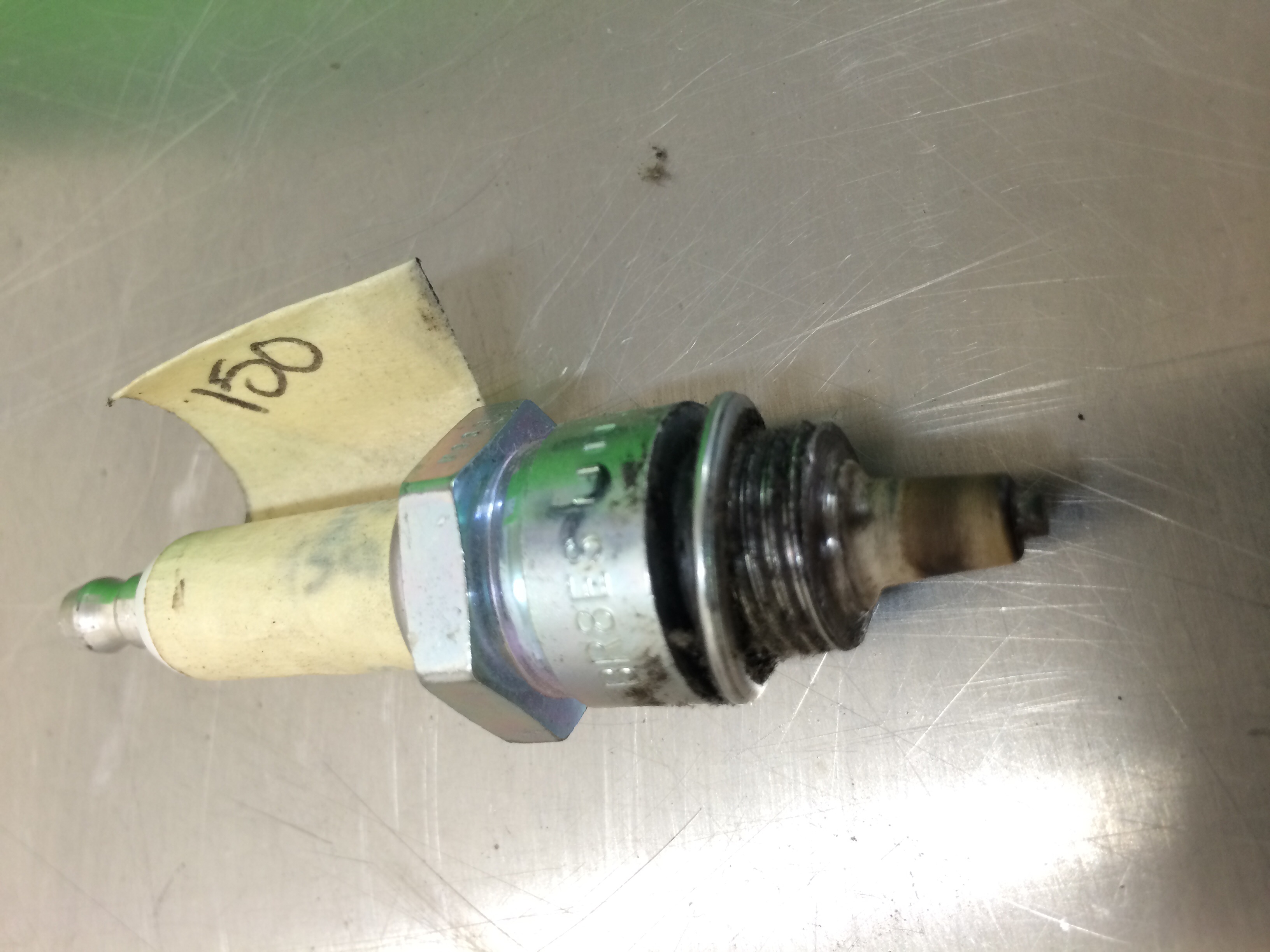

Front plug;
Rear plug;

To me your front plug looks lean and your back way to rich.
Why? I don't know but something is out of whack!
Go back to the start mate, otherwise you will be chasing your tail forever and never get to enjoy the bike for what it is.
Here are my plugs, once I achieved this I have left well enough alone except for the odd synch.

So while I wait for UPS, I thought I would have an experiment. You guys wont agree, but I returned the bike back to almost as it was when I bought it. K&N air filter back in, Dynojet 180 mains front and rear, needle back on the 4th clip with 1 shim each, 45 pilots, left the new OEM diaphragm springs in and left the slides with 2 holes, and fuel screws on 2 turns each. The bike started surprisingly well, balanced up nicely, a barely noticeable hangup below 2000 rpm. Left TPS at 497 ohms. The exhaust note did sound different, maybe not crisper though.
Went for a ride and it seemed better than before though it did get the low throttle lean surge thing under 3500ish. Today I pulled the plugs and this is what l found, front is on the left and rear is the right plug;
Now I dunno about you guys, but I was pleasantly surprised to find those colours. BUT.... the 2 little foam filters in the airbox? Well I am missing one!! Had a look down the carbs into the intake ports and no sign of any melted foam. Without pulling the exhausts off I don't see a way of checking the other side.

I have read that a plug chop is only accurate if the bike is shutdown at the revs & throttle position where the mixture is not right. I am not sure I need to go there just yet.
With the K&N filter not having the triangular sections to retain the little foam filters, the bike will be sucking in unfiltered air through those points, which will affect the mixture. Once I cut out the sections from my old OEM filter and put them in, then I will have a more accurate representation of whats happening.
But yes, it probably is a tad rich.
Twitchy,
Your last comment is an understatement for sure.
The plug on the right is a good indication of where your problem lies.
I am no expert, however the difference is vast!
If I saw that with my bike I would be worried and would definitely target the carb that relates to that plug.
The difference is too great!

So I rode the bike today and it was pretty good initially, but the steady cruise hiccup came back after about 10 minutes. The hiccup was there the entire trip home. About 10 degrees C in the morning and about 26 degrees C coming home. Pulled the plugs and here is the front on the left and the rear on the right;
Now I know the rear is still rich, so I have adjusted the rear fuel screw in 1/4 turn and left the front alone for the moment. The confusing part is that when blipping the throttle, there is a slight hangup. Tweaked front screw out 1/8 but engine note definitely dropped a bit and didn't sound as nice so put it back. I now have my idle sitting on about 1450 and the exhaust note sounded pretty tight. I think I heard what is written as a 'crisp' exhaust note. But the balance was off, and bringing the balance closer together made the revs come down a bit, and the exhaust note sound a bit boggy. I have left the balance level because that is where it is supposed to be. The TPS is set at 498 ohms.
I also find that if sitting idling at the lights for a couple of minutes, the revs slowly creep down to 1100 ish, and I get the clunk die thing. So I have set the idle at just under 1500, about 1450 and we'll see how we go tomorrow. Also found out a guy at work has a proper gauge balance tool so will borrow that and compare my balance methods for accuracy.
NZS, you seem to miss the point of my last few posts. When I bought the bike, it ran fine, did not stumble or hiccup or surge. On removing the carbs for cleaning and inspection, I had not taken notice of the fuel screw position, and was not aware of the need to balance. After reassembling everything, the bike ran like a dog. I got onto the vtr1000.org forum, and immediately it was strongly suggested to get rid of the DJ/K&N setup and go standard. I did that, and it was soooo much worse. I have had the brainwave of reinstalling all the stuff that was in there when I bought it to see if I could restore it to its former glory. I have to say I am a lot closer to a decent running bike now than I ever was with the Keihin mains and OEM air filter. Tonight I will take a photo of the plugs I removed when I bought the bike as a comparison.
I'm thinking you're chasing your tail looking at sparkplugs this way. One must do "plug chops" to accurately check a specific throttle opening (idle or 25% or 50% or 75% or 100%, etc). Plug chops must be done with fresh plugs. I usually buy quite a few cheap ngk plugs for this because i run multiple tests before getting the correct setting.
Find a long, straight road with no one around. Using old plugs: warm the engine up to operating temperatures. Change to new spark plugs. Start the bike, get to 3rd gear, and quickly get to the throttle opening you are testing (idle or25% or 50% or 75% or 100%, etc). Hold the throttle steady at that opening for about 10 seconds, then while holding throttle steady hit the kill switch and pull in the clutch (at the same time). Coast to a stop. Remove the plugs used for testing. Reinstall original "used plugs".
Go home, and use a cut off wheel to cut the threads off the test plugs so you can see the entire insulator. (Read up on the internet about how different parts of the insulator tell different things).
There is no other way to do a plug chop. You can't randomly pull used spark plugs out and see if you're rich or lean. You can't just look at the end of the insulator and get the whole story. You need fresh plugs each time so you get an accurate picture of what is going on.
I've been doing plug chops for a lot of years, and when doing it right this is a very accurate way to test a particular throttle opening/rpm.
James
James
