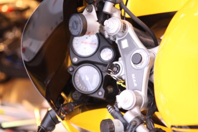

I used the Genmar and they made a huge difference, especially on those long rides. They shift your weight just enough that you don't get the pain in your hands and wrists.
I attached a pic so you can see how they look.

Thread jack: whose GPS(?) stem mount do you have and how do you like it?
