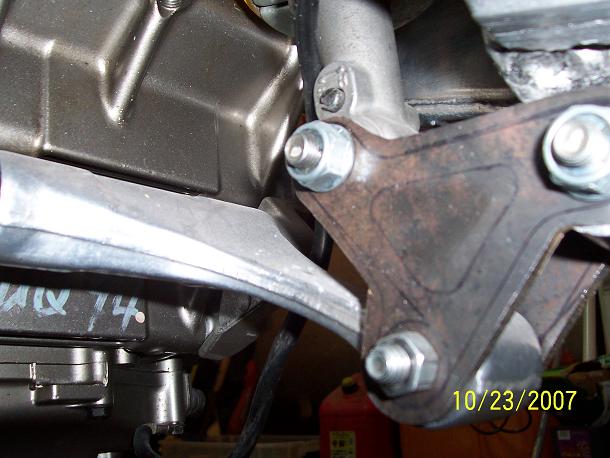

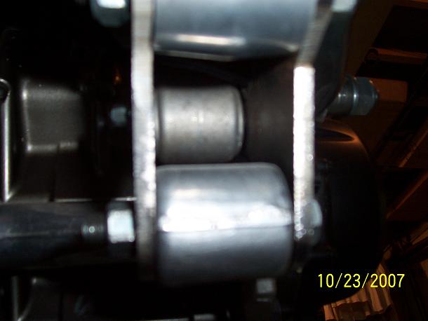

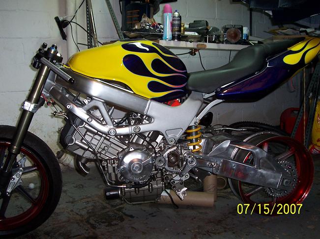

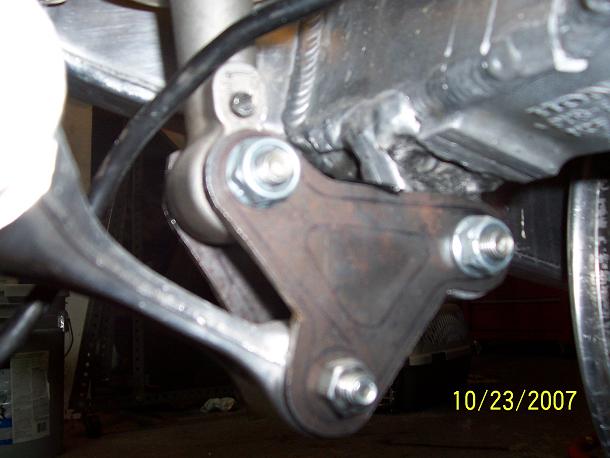

here are pics i was talking about.
Attached Thumbnails other swing arms-shock1.jpg   other swing arms-shock2.jpg   other swing arms-shock3.jpg

Old Oct 24, 2007 | 05:59 PM
hawxter996's Avatar
ole dirty bastard
Posts: 976
From: my house
have a lot of mods planned.
weight loss of bike and myself are planned.
battery and all electronics will be relocated.
gonna try a 600rr radiator,older model new one is too large.
subframe is modded. and exhaust will be fabricated out of stainless.
rear pipe exits under seat and front pipe snakes up and exits left side
above alternator.
most likely baffleless thats where moto gp
shows influence.

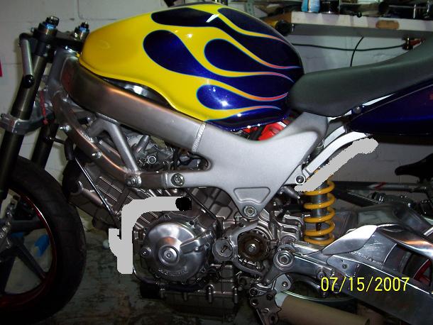

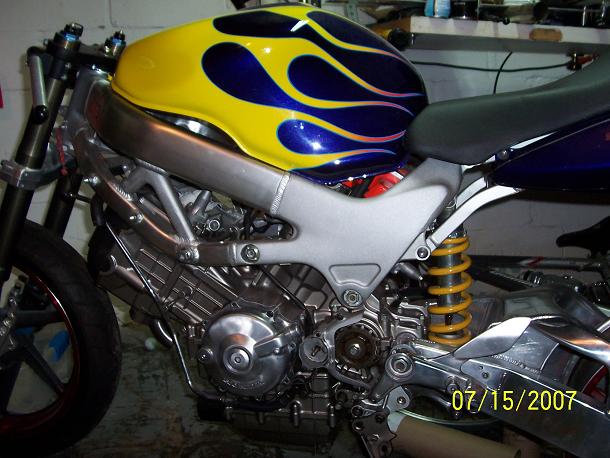

just to give an idea of exhaust routing.
Old Oct 24, 2007 | 07:59 PM
hawxter that bike looks sick! Can't wait to see it (and mine lol) done. Did you take any of the length out of the sp2 swingarm to keep the stock wheelbase or did you leave it alone?
Old Oct 25, 2007 | 04:27 AM
hawxter996's Avatar
ole dirty bastard
Posts: 976
From: my house
i left arm as is.
was a lot easier to setup.
if i had chopped length off,i would have to
do a lot more fabrication.
it does add a liitle to wheel base,but it
just looks cool as hell.
i think it adds less length than vfr arm though.

Alan,
plates i cut myself need to finish trimming them.
photos i posted should give an idea of work on swinger.

Are you trimming round the felt tip pen lines that are drawn on the plates for actual size.

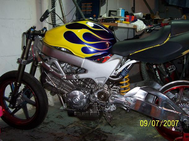

Old Oct 26, 2007 | 05:22 AM
hawxter996's Avatar
ole dirty bastard
Posts: 976
From: my house
chaos
i think i can speak for the rest of us,lets see some pics of that arm before you mount it.

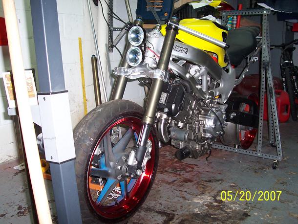

1st pic is as purchased.
2nd pic is after new paint.
3rd pic is current,under going mods.
Attached Thumbnails other swing arms-pp2.jpg   other swing arms-pp3.jpg   other swing arms-pp.jpg
