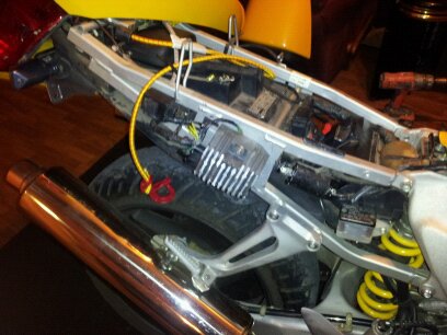

r1 mosfet upgrade
r1 reg /rect done
oh and by the way anyone else looking to find where the red (hot) wire goes on the reg pins it is the one closest to the yellow pins.
