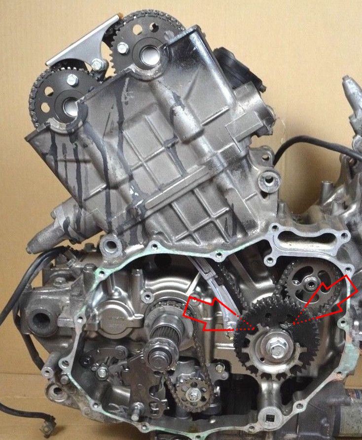

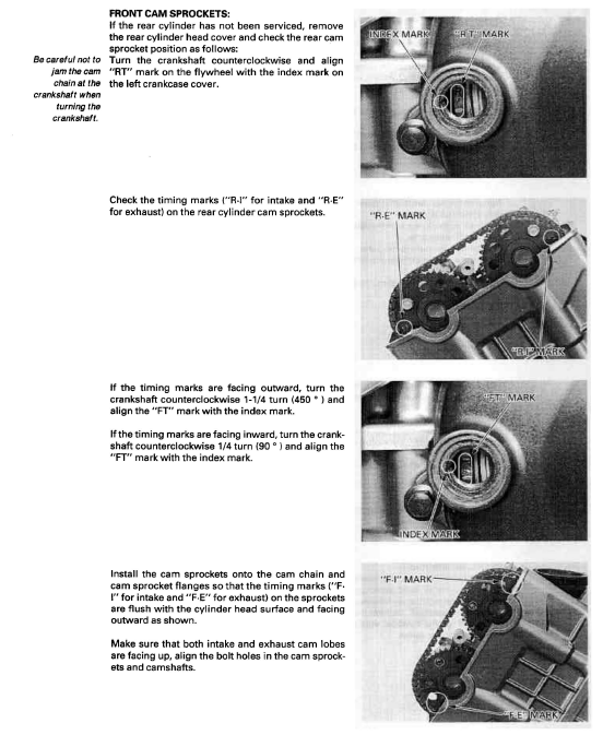

Sounds to me like you need to be checking the cam timing BEFORE you do anything else, as one cause for low compression and noise is if the cam chain tensioner has failed and allowed the chain to jump over a tooth or too. If so you might be doing real damage to the valves and pistons.
At the very least, pull off the cam covers and the timing covers on the engine and confirm the cams are in the correct position relative to the crank. When the "FT" mark is aligned on the crank, the front cams should be aligned with FI and FE marks parallel to the camcover face, ditto for the RT marks and RI and RE on the rear cams (you might need to turn the crank another full turn to get these to align).

Really no need to spin the motor in the wrong rotation. If you keep turning in the correct direction, do you still get the same result?
So the cams are out, where do you have the chains during the spin?

Chains getting bound? How are we holding both at the same time to keep it smooth?
If you are concerned about the bottom, remove the oil pan and have a look. If you can get multiple rotations, then a random seize, I'd suspect the way those chains are being fed to the corresponding sprockets on the bottom.

Are you holding the cam chains up and tight while turning motor crank? If not, they likely are bunching up in the case at the crank sprocket.
get the help of a second person.....have them hold the cam chains up and tight, now turn crank ...NOTE: If the chains are not moving in time with the crank rotation, stop....the chain is off the lower sprocket and if it bunches up you can damage the case.
