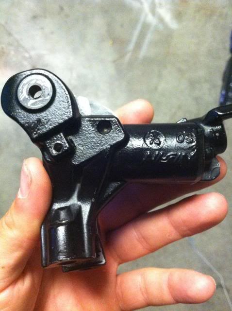

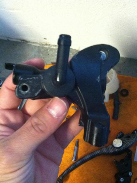

So, when that master cylinder took a dump while riding, i torn it apart and ordered a new one from the local honda stealer. Well, got the part in and it looks nothing like what came out of the bike. Im at a total lost. I ordered the right part, for the right bike, for the right year.
Item #18 Parts Finder Lifestyles Honda Mount Vernon, WA (877) 710-9700
Here is a picture of both the old (left) and the new (right) master cylinder sets.

Old Jul 22, 2013 | 08:00 PM
It appears to me that the MC you have on the bike is not stock. I recognize the internals on the right... the left not so much. You have a pic of your MC?

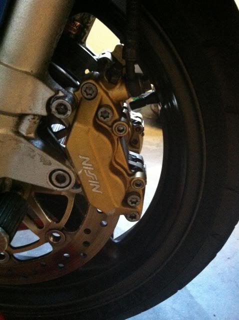

Old Jul 22, 2013 | 08:09 PM
saige's Avatar
the boss
Posts: 1,182
From: largo,fl
if you have a pic of the mc and calipers,we all might be able to help you out with what you have.
if im correct,from your member pic,it looks like you have upside down forks,which could be anything.
but the most common forks for the bike is 900rr,rc51.so you may have front brakes from a 954,929,rc51 .
take pics is the most important you can do so maybe we can help.

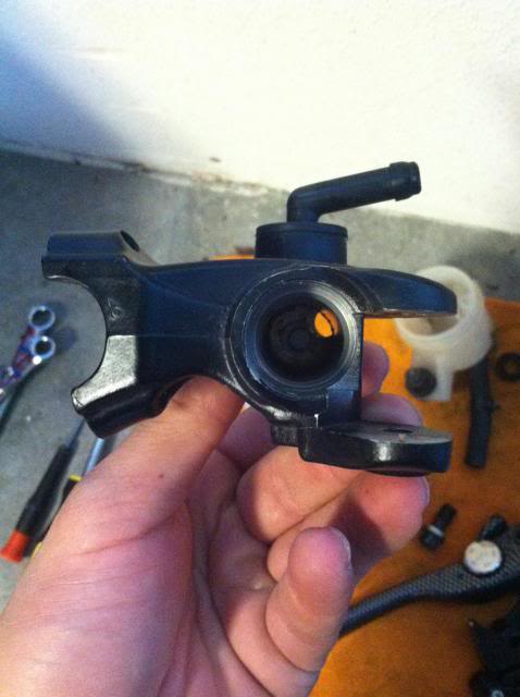

here is the MC and the brakes on it.

it looks like a rc51/929 calipers and mc.
on the bottom of the mc,it will have a number on it.it will be 2 numbers with a slash mark in between.
what are thay?

Ok, ill read through it and see if i find anything. here is a picture of the bottom.
