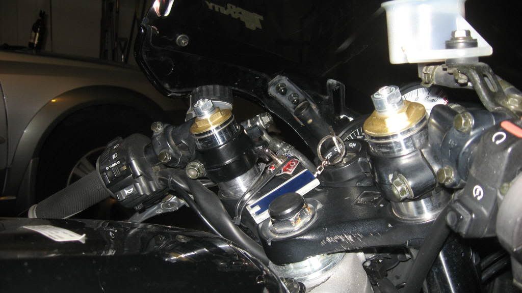

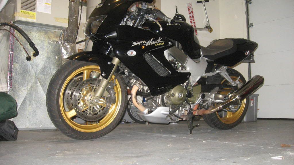

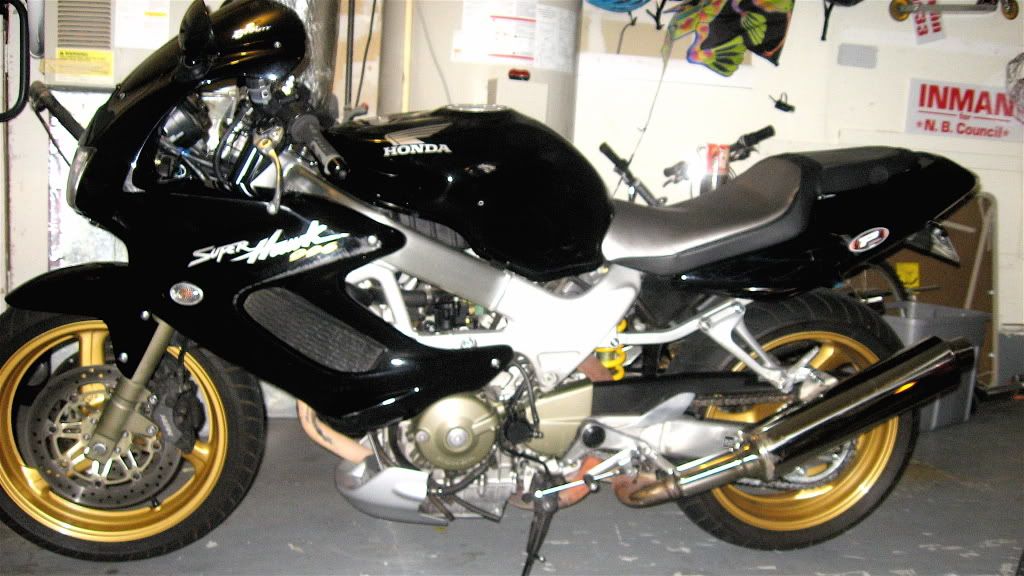

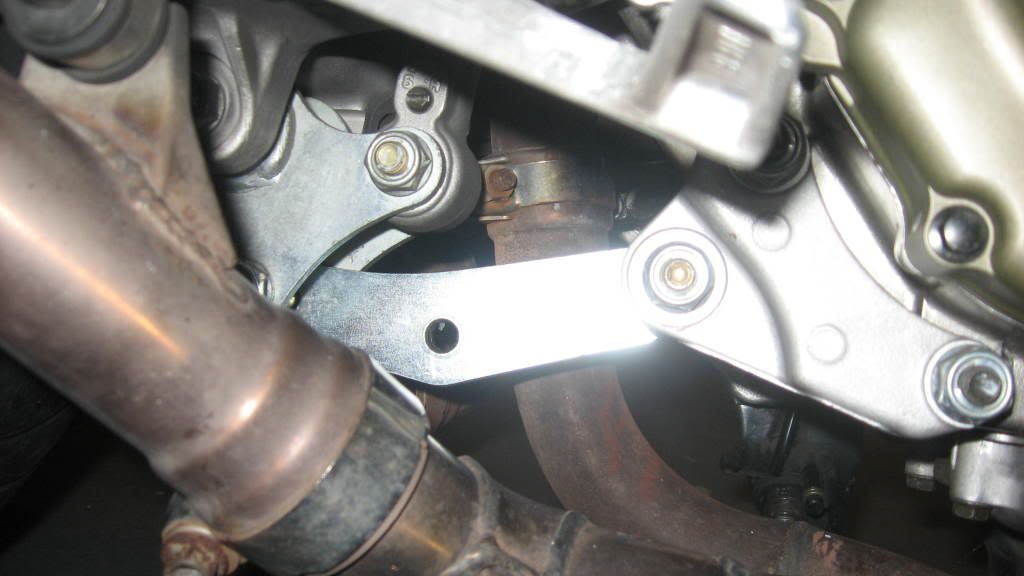

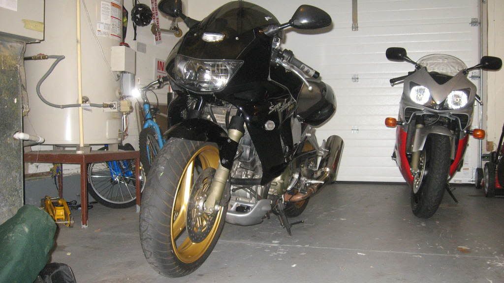

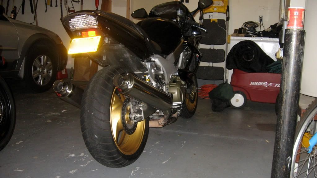

Here is a few photo's of my lowered VTR. I used stock CBR links and spaced it with steel spacers. Dropped about 2 inches in the back, and had to keep the front at about 1.5 inches (clearance). It is more than adequate, I have taken passengers. Trimmed the kickstand, which it's right at the threshold of balance, i will be welding the lip back on it!
Not for twisties mind you! I have drug my toe a couple of times...... always have to adjust my position when cornering tight. But much nicer for cruising low and slow!

The lowering link is done. Very nice part. It's infinitely adjustable via a turnbuckle. It took about 10 minutes to install. Really cool. The pictures are from my bike, 2003 Superhawk, stock headers, Yosh slipons.
