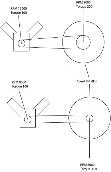

gboezio;
Maybe you're right, you seem sure of what you're saying. I admit I don't get it.
Both bikes dyno 100 ft. lbs. torque at the rear wheel, one at 8k rpm, the other at 16k rpm.
When the 8k bike reaches sufficient road speed that full force can is being transmitted to the rear tire, it is making 100 ft. lbs. of torque at the rear wheel, yes?
But somehow, the 16k bike, which also dynoed max 100 ft. lbs. at the rear wheel is now making 200 ft. lbs. at the rear wheel?

Originally Posted by RK1
gboezio;
Yeah I think our application is a tad complicated
I made this image to clarify to make sure we talk about the same thing, I oversimplified the tranny by using a chain since we just care about the gear multiplication we are in tu run at peak hp.
You got to love my beautiful V-twin
I might add the energy (hp) is produced by the engine and can't be altered by the driveline (except friction losses), it's components (torque and RPM) can be traded one for the other in that said driveline.

gboezio;
That is indeed a very handsome looking V-twin(s)! And I appreciate you having taken the time to draw it.
But since the starting point for my "shootout" between the 8k and 16k bikes was that they each make 100 ft. lbs. max torque at the REAR WHEEL, I still don't get it!!!

Ah, equal torque, equal speed = equal horsepower.
But something have to give, the torque have to be reduced to 50 lb/ft on the engine reving 16000 to be equal at the wheel, or go twice as fast, if not, the engergy can't be lost and the clutch in the tranny is taking 50 % of the power output as friction and heat.
