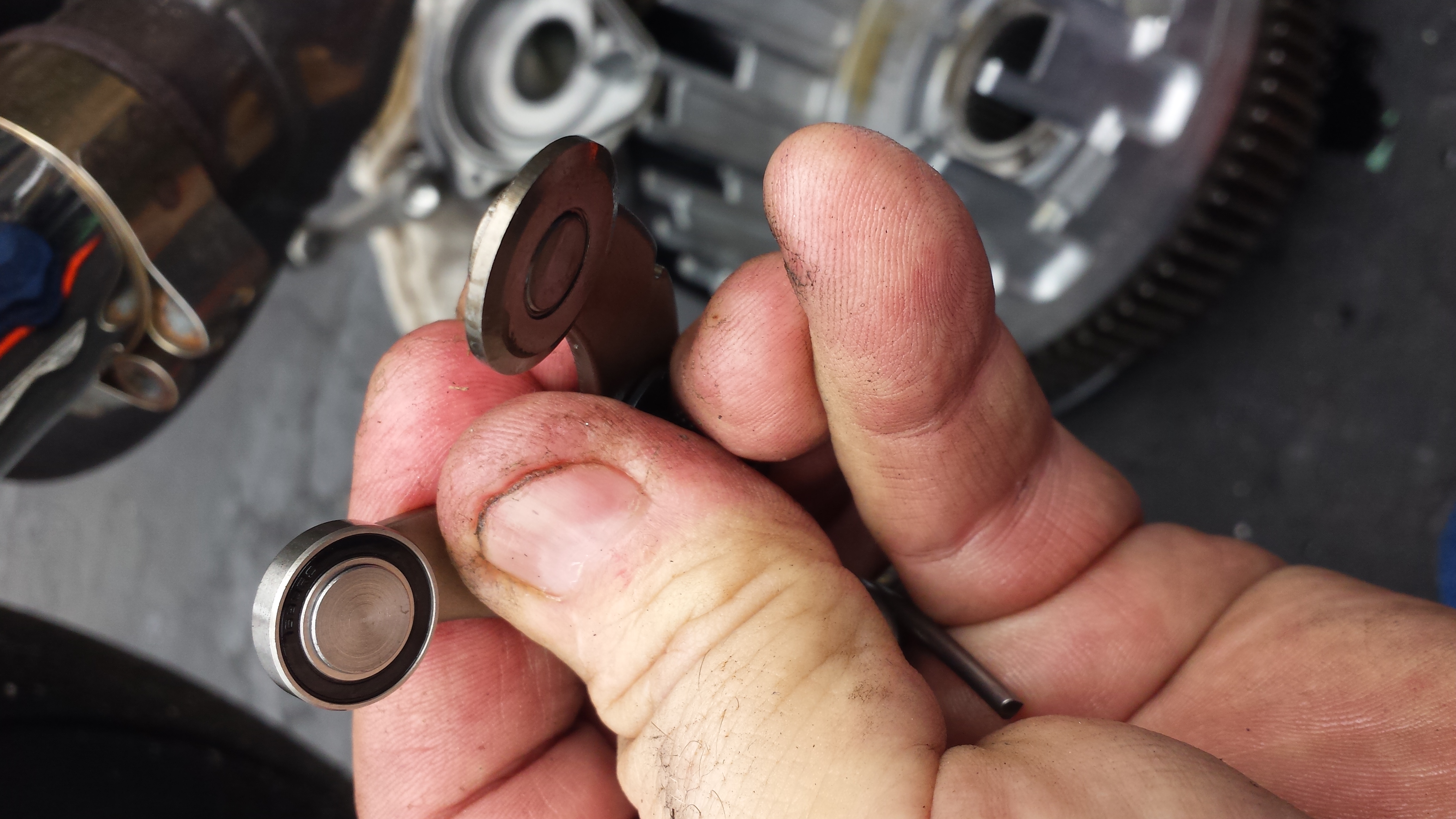

Hi guys, following the last few posts regarding the differences between the shift stars, check these out;
The OEM spring is noticeably thinner gauge than the FP piece, the roller (bearing) is obviously smaller diameter, and the star itself has considerably lower peaks and rounder valleys. Also the OEM star seems to have pins that press through from the back, where the FP piece seems to be milled. The recess for the bolt head is larger on the FP unit, presumably to reduce weight, which is more surprisingly, but looking at the back, it is one solid section.
Hopefully this helps.
