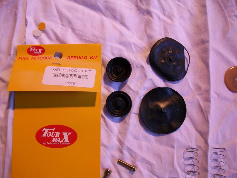

Hey all, had to replace my petcock diaphragm set, found out that the parts from the GL1500A Aspencade (1991-1995) Fuel Petcock Repair Kit are the same except for the spring which is reusable anyway, found the best price here, http://www.carbkitscapital.com/carb_kit_list_model.php?make=Honda&model=GL1500
$13.00 plus shipping, cheapest I could find for the VTR was $23.95, got it fast too.

Yea, that's odd that you had about the same size hole in the same area that I had on mine.
Funny this gets brought up, just as I had replaced mine this last week after I found a healthy 1" hole ripped the air vacuum diaphram. My replacement was a K&L for about $16 or something; ordered through the Honda shop over here in Portland OR. Part# stuff is: FCK-42 Petcock Rep Kit, and under the barcode it reads: 18-5015.
It came with four replacement screws, both diaphram bodies (Gasoline cutoff and air), and two springs (There isn't supposed to be two installed though, is there? ...I was thinking they threw an extra one in just in case the other one decided to fly off somewhere.)

Spaz, the two springs probably to cover a range of years and modles. Cap'n doncha love when ya out fox the foxes' lol.
