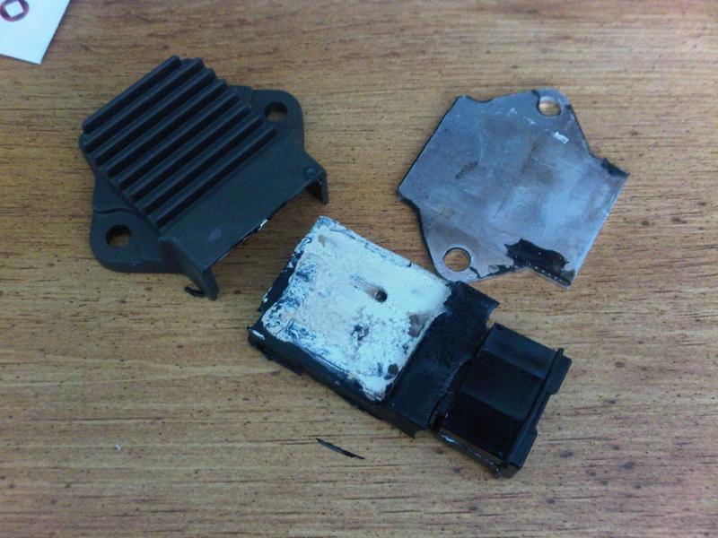

stator shows 80v, my mechanic buddy came by, the reg blew, i pulled it out in literally 2 pieces, so yeah, thats exciting. that stink has filled the garage and the bike permanently i think

Old Apr 15, 2010 | 02:21 PM
uchi's Avatar
Posts: 1,978
From: thorold ontario
Nice huh

Originally Posted by uchi
Nice huh
looks hauntingly familiar. as I stated above, I installed two batteries and two RRs before success. First battery Advance Auto-not properly charged; First RR rebuilt from Ricks. Second Battery Yuasa-charged acc to instructions;Second RR-Honda. The second time I installed the battery, I hooked up the grnd first, then held the hot on snugly with my fingers while i watched, listened and smelled for the ominous melt down that thankfully didn't occur. happy trails, or maybe I should say happy trials.

Haha don't jinx it or you're gonna have to come here and install the next one. Lol. I did the same with this one. Put it on. Held it. Didn't smell anything. Didn't see any sparks. Didn't hear anything. So I proceeded to connect it. So I'm hoping it was just the luck of the draw and I got a unit built on a friday at closing time. Lol. But the companys pretty good about things. They sent me a ups shipping label and everything its just a pita to fill out the paper work. One question on there asks if the resistance was checked and what the readings were. I said there was no need to. It smoked a little. Smelled bad and started to brown my wiring harness. Oh and it came out in 3 pieces so I'm gonna go ahead and assume its bad. Lol. Chick on the phone was cool. So we'll see how long the turn around time is on this. I'm shipping it this morning. So let's say by tuesday they get it. And let's see how long before a new one arrives.

hahaha. Yeah. if it came out in 3 pieces, I'd say that it has definately "departed", both literally and figuratively. hahaha. Hey we gotta laugh, huh, or we might have to hurt something.
