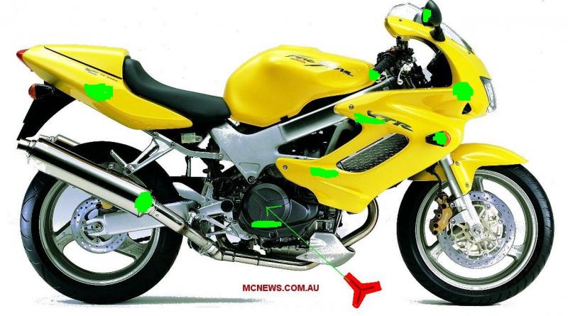

I'm gonna say it up front that this might seem like a retarded post, but bare with me:
Many months ago I've wrecked my VTR (had an accident).
I'm thinking of gettin' a bike early next year, and the only one I've got my mind on is the VTR.
Before the crash I dropped the bike two times. (once some **** cut me off,without any signals or whatsoever, and another one due to my own stupidity).
Now I've come to learn that no matter how careful you are with your bike or how well you might think you can ride or how well you can look after yourself, **** is gonna happen, at some point.
After my second fall (at about 30km/h when the bike skidded on the asphalt on one side) ,I studied the damage and I leaned the (standing) bike gently on both sides, to see which parts are prone to damage,should the bike fall on either sides.
I've attached a pic with some parts/areas where I think damage will occur if a small crash/fall happens.
I've seen that stock exhausts (which I had) work very well as crash-pads (i've painted in green where the exhausts take the beating).
Protecting the parts of fairing which might take the 'hammering' is quite difficult/next to impossible, but I wanted to know if there is any protection for the clutch box ,some sort of tri-metallic brace which can be mounted over it, to prevent crack/damage if it skids on the asphalt.
This might sound dumb, because I assume that mounting standard crash-pads might prevent the clutch box getting damaged,but i'm not sure yet.
I believe that with stock exhaust and a pair of crashpads the bike should be ok at a gentle drop/minor fall.
Changing the exhausts to aftermarket ones will put some serious damage on the tail (fairing)
I don't wanna sound like some obsessive-compulsive suffering bloke,but why not do everything to prevent any damage, with very small costs, because these sort of damages can occur very easily.
This only applies in small crashes,of course, which can happen to anyone.
If you have any ideas, by all means......

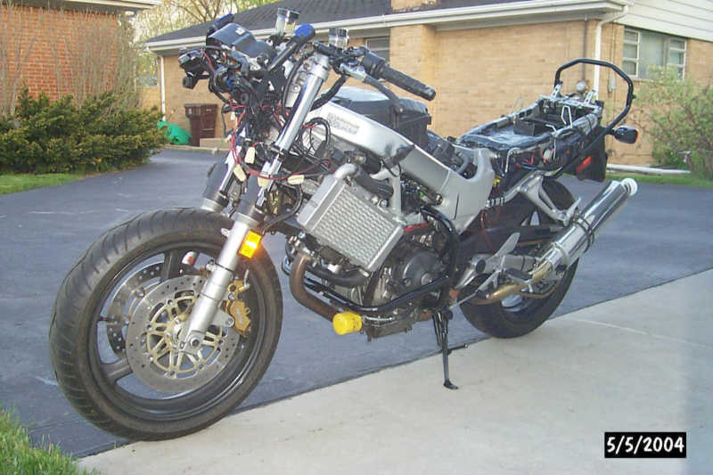

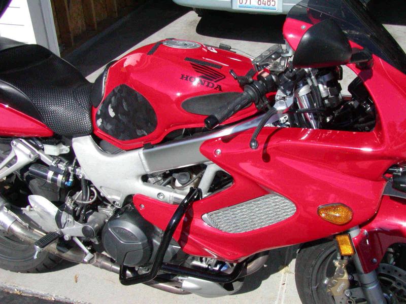

there are a bunch of suppliers of the crash bobbin type protectors - they will help avoid major damage in a low speed tipover/slide. If the bike high sides or flips, who knows and you'll still get some damage.
These types of cages are also available. Someone had some fab'd up for the SH a long time ago and you might find some of those used. otherwise, the stunting suppliers will have them. They can impact cornering clearance if you are a very aggressive rider - so you'll want to check on that.
http://www.komodogear.com/store/vtr-...gine-cage.html

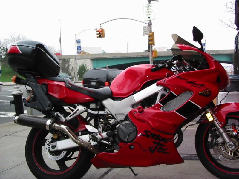

The stunting stuff is really for.....stunting. T-rex sliders have save my bike in 2 crashes (still same bodywork; no repair needed). You can get a set of F4i ones cheap to put as exhaust can sliders.

smokinjoe- you used F4i sliders there? I am interested in a cheap non "no-cut" option

thanks for the opinions. a stunt-cage is out of the question.
I wanna ride a normal bike,not a stunt bike & look like retard that can't ride 2 wheels
I'm not addicted to aesthetics,but I can't ignore 'em all the way. I mean I'd rather ride with a small dent/crack in the fairing ,or polished exhausts than with a cage...
I was just looking for very very light body work that can minimize the damage of a potential fall/slide.
When I'll get the bike I'll definitely get some crash-pads (that will keep the fairing a bit more protected).
Still thinking of some sort of clutch cover...
And some sort of rings over the end of the (stock) muffler, to take all the sliding..

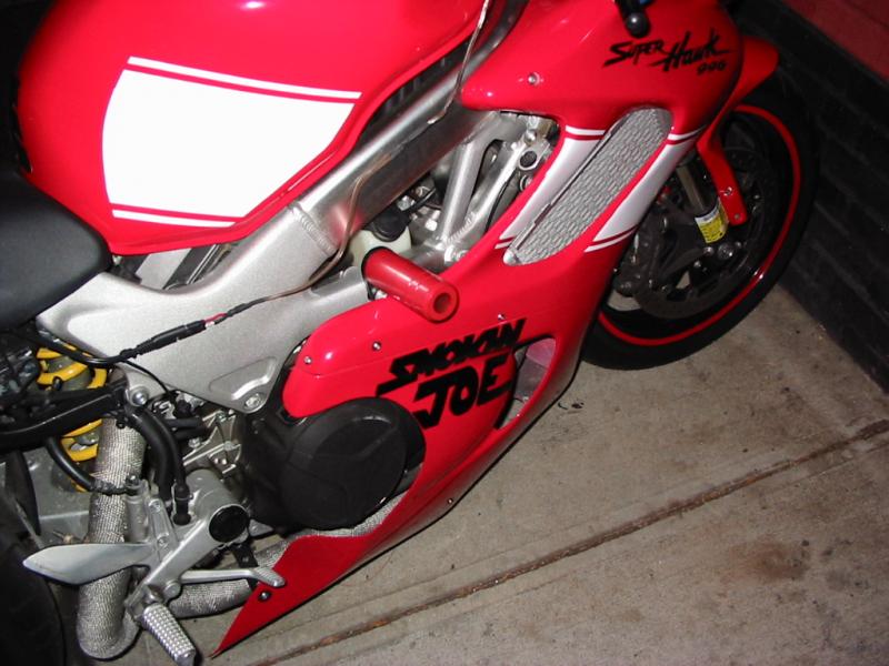

T rex is just the brand. You can get them on ebay I believe. I have F4i on my daily bike & the "no cut" which are alot longer on the summer bike. The rest of my sliders were delrin you can buy in bar form from McMaster-carr.com by the foot and easily machine. It is almost cheaper to just buy F4i ones & just bolt them on at the passenger pegs. It is easily cut to adjust lenth. Bar ends can be made the same way.

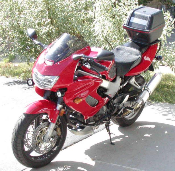

4-pt mount & cross-braced case guards
the best coverage & light weight protection short of a Trojan I found...

nothing moral about my comment, I gave you a suggestion for several options including the most protective device I know of. You mocked it calling it 'retarded' I believe (for all you know I could be using a cage device like that). I think there is some growing up potential here, but suggest you just try to meet people half way. Its a very helpful friendly forum, but do some searching first, and if someone suggest something as an option don't mock it. And finally, not to be too P.C. but who uses the term retarded like that outside of teenagers? If you've had any personal experience with learning disabled it really hits a nerve when you throw it around like you do.
No! don't get the cheap knock off ones. I did and the slider snapped right off. The bolt stripped all the threads in the mount and ruined all kinds of my bodywork. I got the actuall T-Rex sliders now and I put a nut on the back of the mount to make sure the long bolt does pull out.
Here's the 905 cage I saw:
https://www.superhawkforum.com/forum...=frame+sliders
