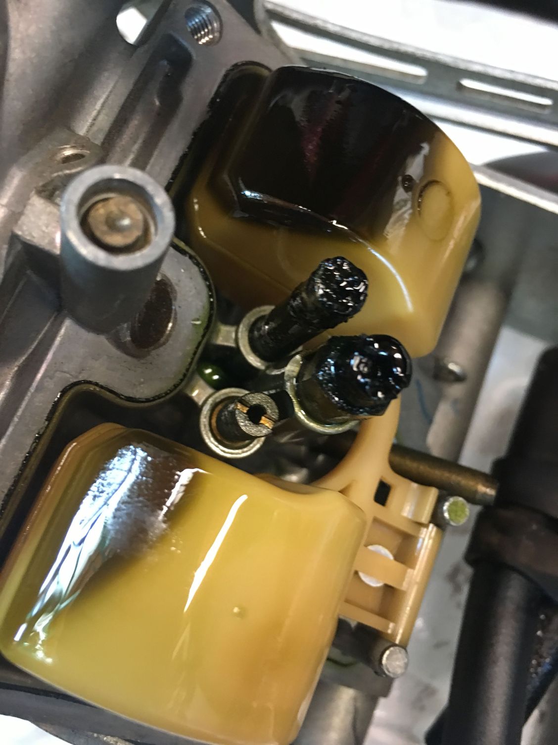

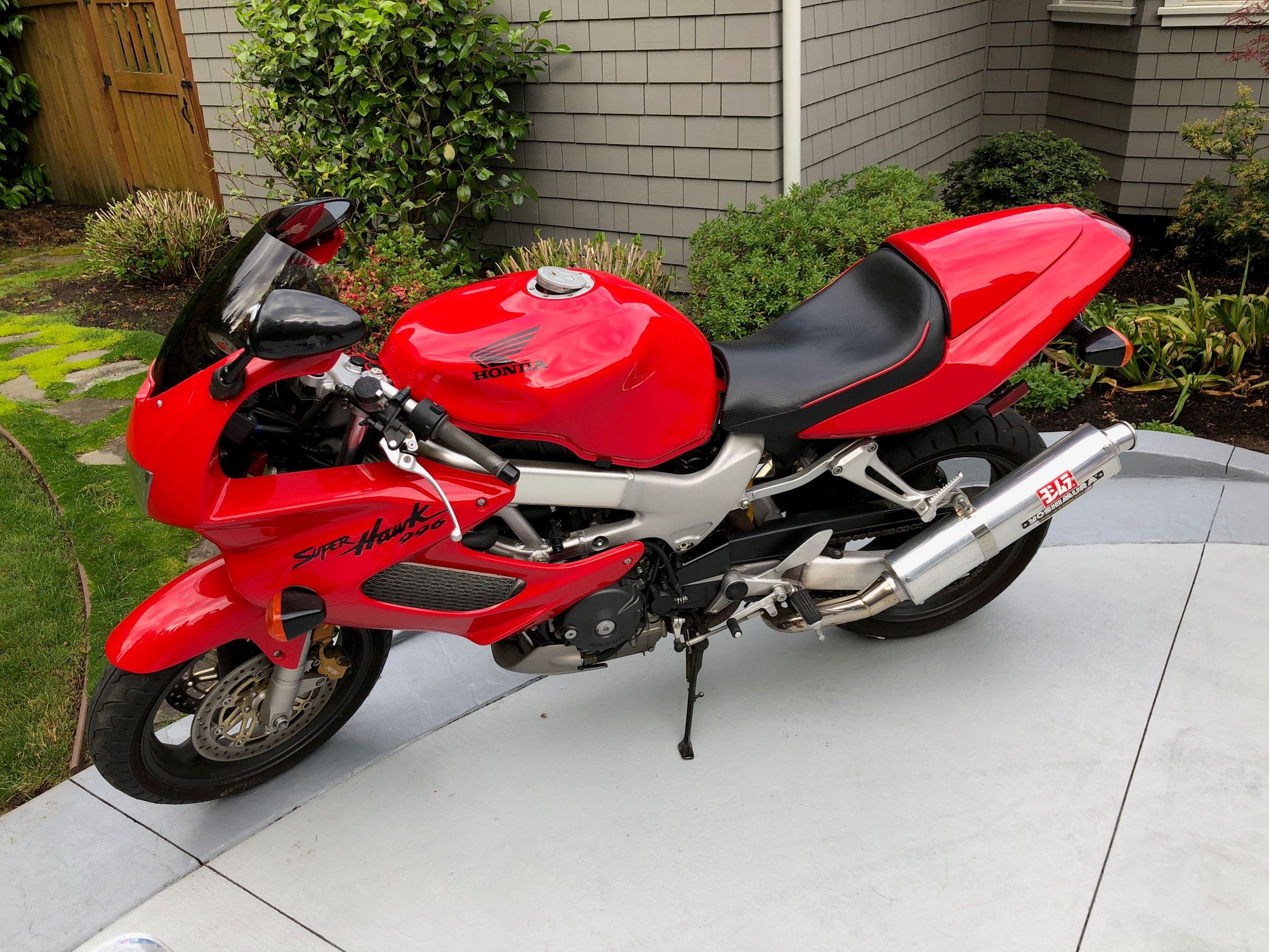

Hi all! I just bought a 1998 superhawk with 10,000 miles. She has been sitting for 10 years but is in absolute pristine condition. Unfortunately she wasn’t properly fuel stored. I’m relining the tank and have the carbs off, they are gummy and not rotten thankfully, and I’ve been reading all the posts about do’s and don’ts. Besides the obvious tires and oil is there anything else I should look at while it’s apart? https://cimg1.ibsrv.net/gimg/www.sup...2c4cb7c3b.jpeghttps://cimg9.ibsrv.net/gimg/www.sup...eeb613593.jpeg

smokinjoe73 Jun 5, 2018 07:25 PM
I'm gonna say firstly that those carb pics are going to give me nightmares.
For sure brake & clutch fluid, install fuel filters inline. Coolant of course.
Did I mention the nightmares. Geesh.
Awesome bike though. Like a time capsule.

I purchased the bike for $900, and I’m in Bellingham WA, after removing the carburetors I’ve decided to purchase another set. Everything is frozen solid on them. I do plan on replacing all fluids as well. All good ideas. I’m curious about the CCT’s though and why sitting would damage them. I believe my mechanic skills are good but I’m a bit nervous about that part.

Find someone local with an ultrasonic cleaner. Save some coin.
