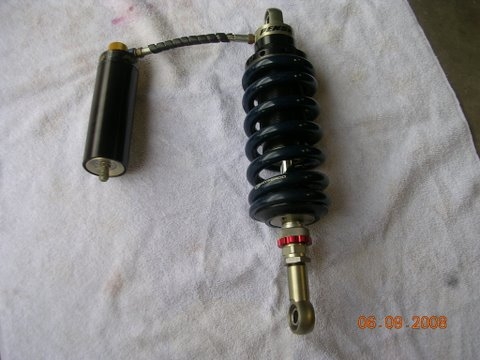

Where from & 4 how much. I've had mine for 3+ yrs and the shaft seal started leaking last season. $125 for a rebuild!
Skokie, I rebuilt mine for around $30 including all new seals and oil and bought enough to do it again one day
I bought my parts here outta a race shop in NC...these guys really know their stuff!
http://www.resuspension.com/8100-p-1-c-79.html
Good luck,
RC
Old Nov 14, 2008 | 08:30 AM
Posts: 2,223
I was concerned about not having a spring compressor and other tools required for the rebuild. What parts exactly did you require and what equipment & tools did you need?
Thanks
Good luck,
RC
Old Nov 14, 2008 | 08:45 AM
FL02SupaHawk996's Avatar
Fastest Color
Posts: 2,091
From: Lithia, FL
Thanks
No spring compressor needed bro
Just make sure you get the right tool to grip the shaft bearing with in order to tear it down...this is the one that fits mine:
http://www.resuspension.com/SHOCK-WRENCH-p-15431.html
If yours is leaking I suspect it's only the shaft wiper that needs replaced...$7.50, but I'd call them and they'll confirm all the parts you'll need to get a good rebuild done and don't forget the oil
RC
