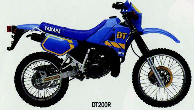

I picked up a 1990 Yamaha DT200R last summer (my second one; model was never imported into the US). Actually, I began looking after riding a new Yamaha WR250R test unit. The engine is the poster boy of user-friendliness; at idle you hardly hear it (quieter than the WR), you can lug it like a trials bike yet it still pumps out 32 hp on top, all the while getting over 60 mpg. Also, it is MUCH lighter than the WR.
that is like a liquid cooled variant of the blaster engine. i would love to have one of thouse engines but they are hard to find state side.
Old May 15, 2009 | 11:36 AM
yep, has the electric YPVS too. Very nice package!
