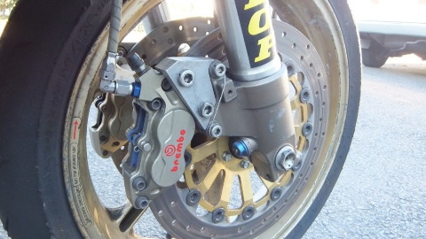

Finally did the front end swap ive been wanting to do for so long, the RC51 swap. It was about a 9 hour process from start to finish on Friday. I was really surprised at how smoothly it all went, which is where my research and preparation really paid off. I was lucky to find a complete SP1 front end, with the exception of the SP2 wheel which is lighter and cooler because its 5 spoke rather than 6. I wasnt sure i wanted to dive into the process of a swap but when i found the steal on all the parts i jumped.
I went with tapered bearings from all ***** which are great! i also took a risk and bought a pair of the 3 way adjustable danmoto clip ons which so far im really happy with. Although its a little time consuming to get them in the same position and also one your comfortable with. I also only had to make minor modifcations as in trimming the inner fairing and the streering stops. Didnt need to move back my radiators as the triple or forks dont come anywhere near touching them.
Today i took the SHawk out to the infamous "Snake" section of mulholland canyon, which is my local riding spot, and WOW!!!!! what a difference! its like i bought a new motorcycle. i already have the ohlins rear shock so the new front end really compliments that well. the front end felt so planted. The best way to describe it is confidence inspiring. No chatter, No flex, and the bight on the brakes is killer. I wasnt questioning the front tires traction at all. I definitely went faster because of the confidence i had in the front end. So much so that a buddy of mine noticed how much faster, and lower i was going then before.
It was the most worthwhile investment ive made in the SHawk. I definitely recommend either the RC, or any other USD swap to anyone who hasnt done it. It really reminded me how vital good suspension, and more importantly properly tuned suspension is. Cant get over how much of a difference it made. STOKED!

Nope. According to some members here, a correct re-valve and re-sprung stock fork is more effective than a USD swap. Hahahahahah! Quit spreading lies, heretic!

NHSH, i was getting at the point that properly tuned SHawk forks even with a fork brace will NEVER be as good as properly tuned USD forks. just like properly tuned drum brakes will never match disc brakes. thats why RSD forks and drum brakes are a thing of the past on motorcycles. at least sport bikes anyways

Actually, it is. Something to keep in mind is the RC51 front will also need a revalve and probably springs too. It might be hard to believe right now because it seems like a big change, but it is true. The valving pistons inside the RC51 forks are the same exact parts as the VTR. A USD set of forks offer better rigidity and the RC51 has better brakes, no question about that. I rode my GSXR750 front (which has a lot better stock valving than the RC51) for about a year before setting it up properly, it is pretty amazing what the correct springs and valving does.

Don't be so hasty. I would suggest you start with springs and a revalve to your VTR forks first. The valving will always swap over to a USD set if you choose to go that route in the future (as mentioned above it will need it too).
As you ellude to, USD swaps are pretty expensive. Honestly, if I had it to do over I probably wouldn't do it again. Since they are already on my bike I'm not taking them off, but a properly setup set of stock forks is almost as good.

900RR forks, while RSU, are a definite step up too (much more rigid, compression adjustable, and lighter too). As they allow you to keep the front wheel, rotors and calipers, they make for a much cheaper swap too. In fact, they were used by Moriwaki (and Revolution Racing) on their racing VTRs, so they should be up to whatever we can dish out...

I definitely agree with you Jamie, and your the god of suspension around here so i take your words as law. like 7 i didnt know valving can transfer from one setup to another. is this true of all forks or only similar forks from on manufacture? what does a respring and revalve cost? and is it basically dialing in the suspension for bike + rider weight? i cant say that the fact that the USD forks look so damn cool didnt have anything to do with my choice to do the swap but they also really transformed the bike. So Jamie, if you say the RC forks need springs and a revalve then consider it done! as soon as my wallet allows it

For most street riding you wouldn't notice a much of a difference. The RC51 will feel more rigid but that won't translate into more performance until you get to knee-down levels or faster.
Some people like stronger brakes, and the RC51 does have a bit more in that department. Personally I have always felt the brakes are something meant to slow you down. The less you use the brakes the better.

I've just gotta say that the stock forks on the vtr will NEVER be as good as USD forks. If both are properly valved and sprung then the USD forks will still preform better. I did the swap for looks cuz they bring the bikes look up to date, rigidity, better braking(which yes is really important contrary to what's been said) and lighter weight of unsprung rotating mass. Overall the swap was a huge upgrade and I sold my old parts coming out $50 shy of breaking even on the whole thing. So it was almost free.
