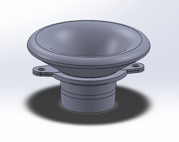

So I've been doing some research about bellmouths for engine intake manifolds. There is one article that I think has everything we need:
Best Bell; Gordon P. Blair and W. Melvin Cahoon
http://www.profblairandassociates.co...mouth_Sept.pdf
I found the science and arguments to be compelling. Also, they give a very concise formula for building your own bell mouth. Which I have done.
First article bellmouth. No method for bolting it to the airbox.
The recipe I followed is as follows:
ELL-L-De-Di-Rc
ELL-47-47-100-8
Where:
ELL = Elliptical transition down to inlet pipe
L = Length of bellmouth (or height)
De = Diameter of exhaust port (of the bellmouth)
Di = Diameter of the inlet port (of the bellmouth)
Rc = Radius of the corner
All dimensions are in 'mm'
I included some material in the throat or pipe section that is parallel with the carburetor throat because I want to be able to get at the screws that I'll be using to hold the bellmouth down. So the actual overall length is longer than the theoretical. This is ok because the bellmouth is really only bounded by the opening and the point where the outlet meets the intake tract of the pipe it is feeding.
Superhawk carburetor bellmouth base dimensions
Things to keep in mind:
* We're only trying to do better than the existing intake tract.
* The paper describes performance increase compared to a straight pipe with a simple ball radius
* The best we can hope for is a maximum of ~3.5% improvement over the straight pipe with simple ball radius (aka 3.5 hp on a 100hp machine)
* The existing design is OK but was selected for space constraints within the airbox including the breather piping, manufacturability, and need for extra fuel to cool the rear cylinder.
* The existing design is probably better than the baseline used for comparison in the paper. It has a taper (shallow) and a corner radius.
My expectation is ~2 hp but I'll have to do some tuning on the carb to get there.
This is a lot of fiddling around for 2 hp.

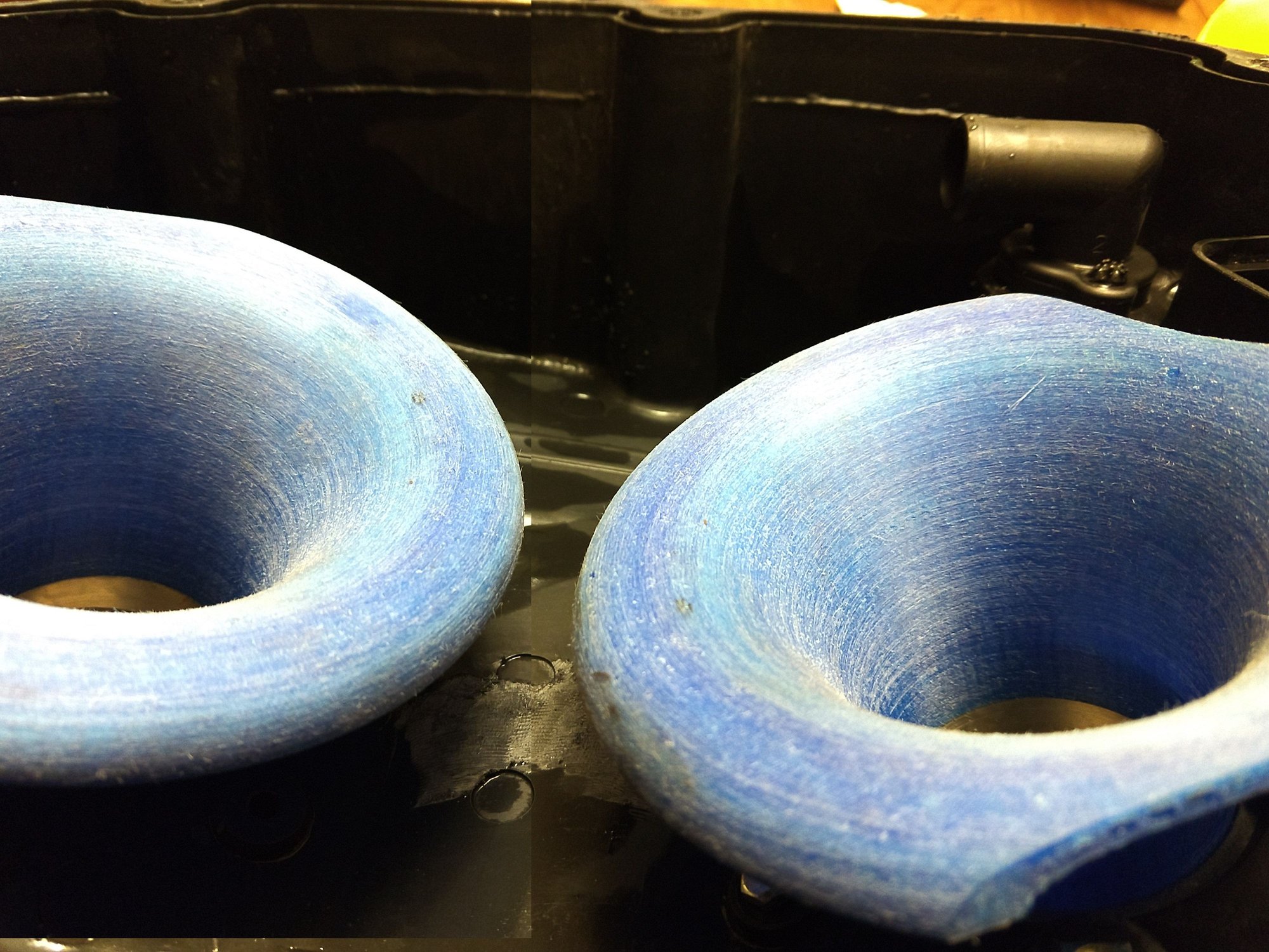

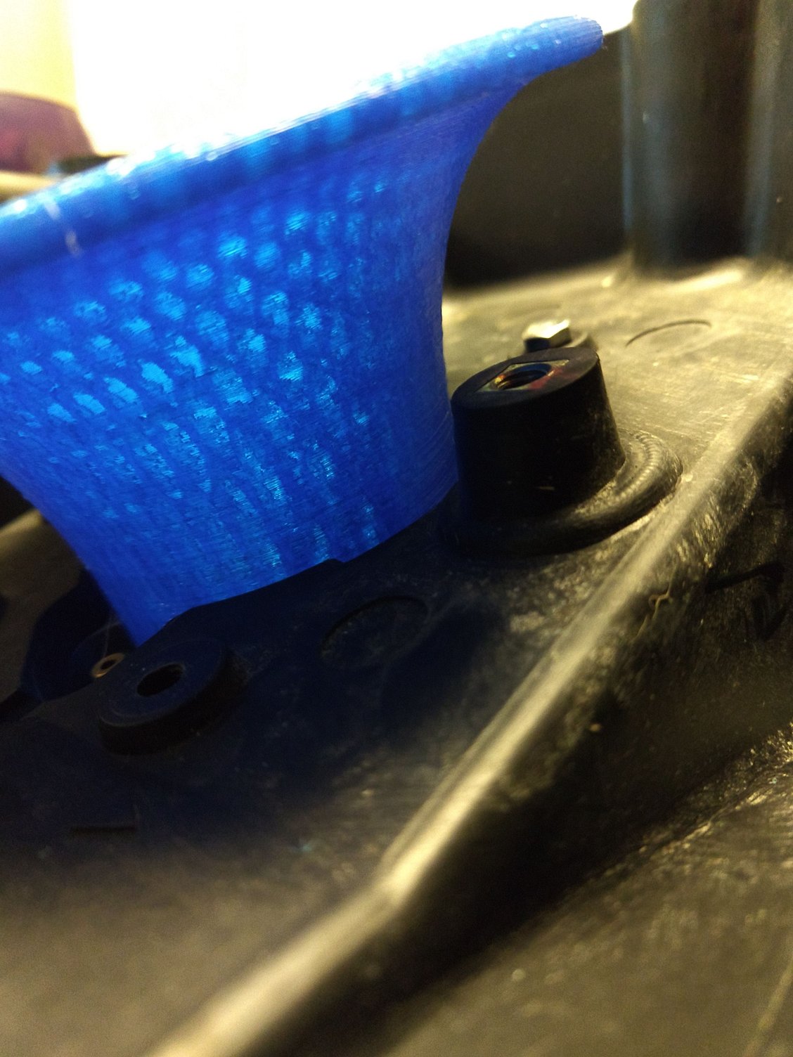

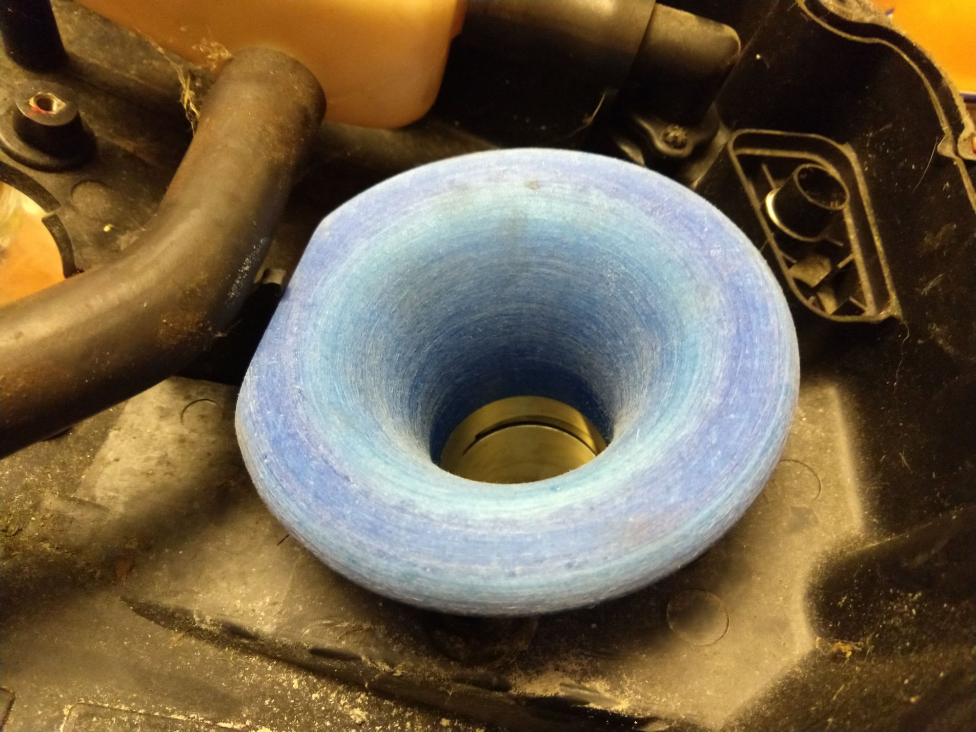

A couple of more pictures of my first article.
Superhawk bellmouth installed on carburetor.
Base bellmouth weight.
Superhawk bellmouth transition is very smooth.
If you want any other views, let me know and I'll see what I can do.

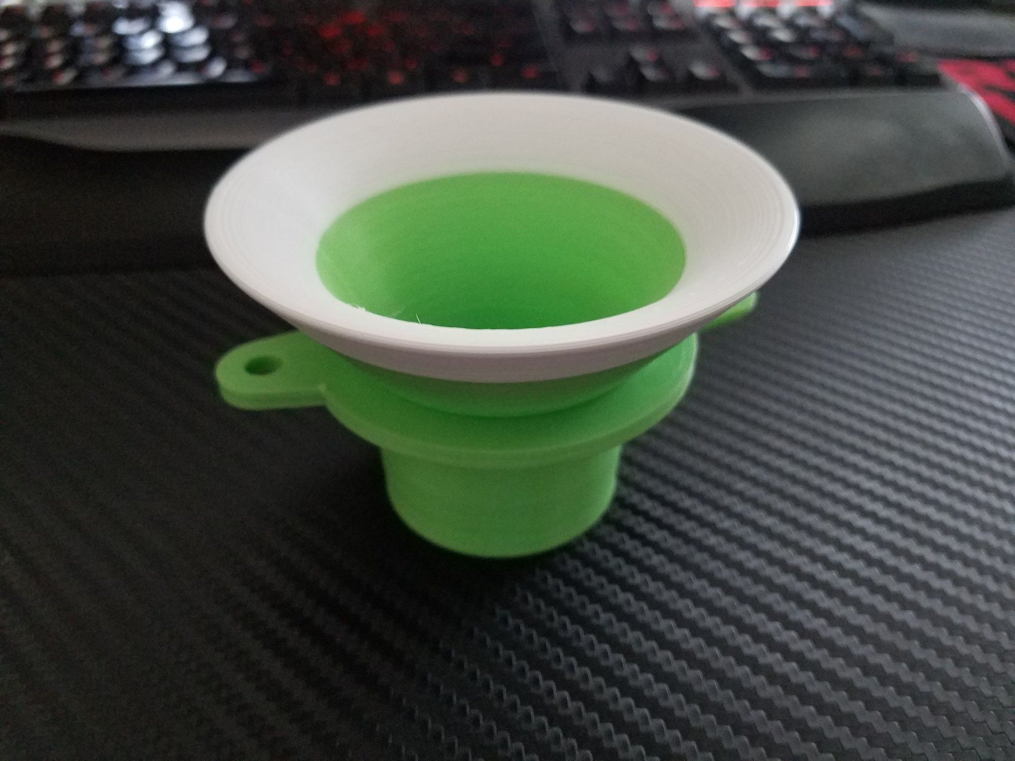

Old Oct 1, 2019 | 08:32 PM
Floyd's Avatar
Joined: Sep 2017
Posts: 197
From: FL
Here is kinda a rough of what I have. It was taking your shape and adding Felix's hold down idea in two halfs. Im also trying to add under the bell so I can print without support and get a real nice round on top.
Id have to take my tank and airbox off again to see what all room I have in there for the design. Yours feels like it might be on the big side but im not sure until I can take more measurements.

Old Oct 2, 2019 | 06:39 AM
Floyd's Avatar
Joined: Sep 2017
Posts: 197
From: FL
Trimmed away a bit for this. Took a bit of meat out of the top end.

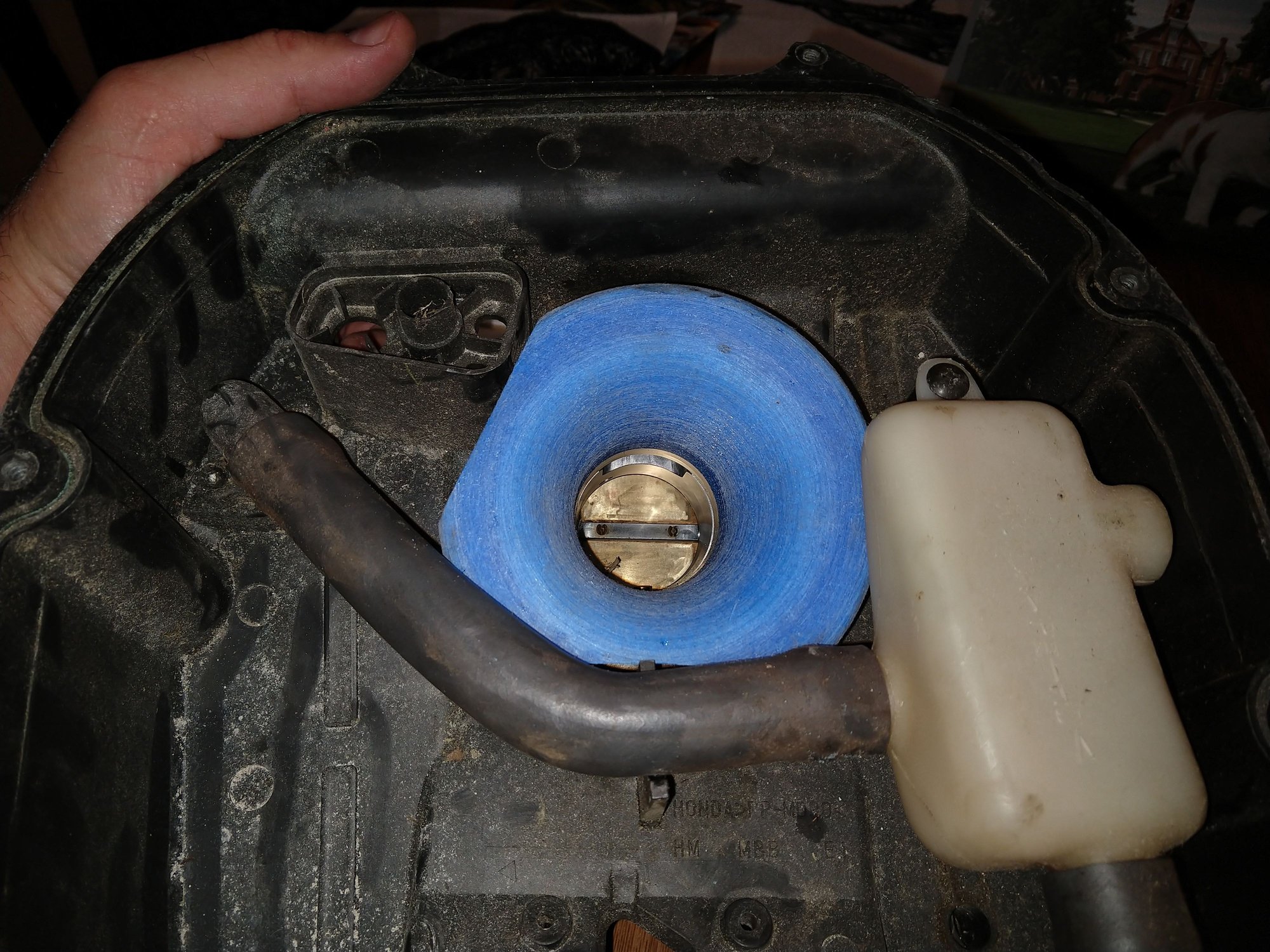

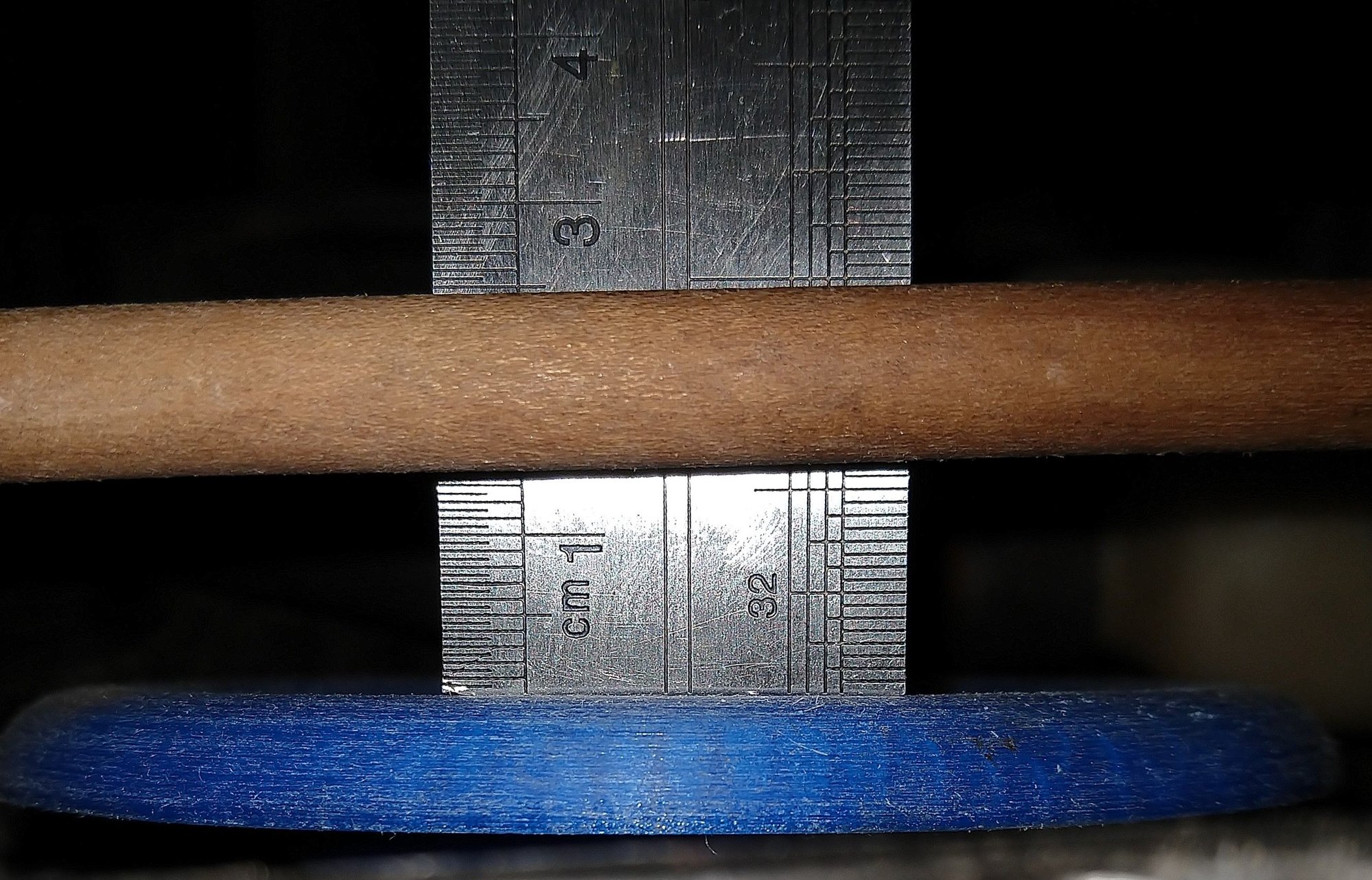

So I did a bunch of measuring and mocking up. My conclusions are this:
1. The bottom of the flange that secures the bellmouth needs to be 33mm from the surface that meets the stopping ridge in the carburetor.
* Depth from stopping ridge to inside floor of airbox 20mm (almost dead nuts)
* Height of brass inserted bosses ~12.5mm (there seems to be a bit of variation)
* We want a little pressure holding the bellmouth down 0.5mm (or 0.020")
* The fasteners are 5mm
2. The geometry I selected fits rather well.
* All the breather piping and support structures have to be cut out (we need to put some kind of labyrinth feature into the piping opening - 3D printing?)
* The corner radius can/should be slightly trimmed to fit the front carburetor because of the breather trapezoid interferes. (I think what Floyd has is pretty good)
* The clearance below the air filter is about 12mm at the closest point. I think a 5mm reduction in height overall would be a good idea.
* Accessing the fasteners is rather cumbersome with the current geometry. Better with Floyd's tweak.
* The front and rear belmouth do not clash
In general it fits. Rear Carb.
Notching was kind of aggressive and the breather piping had to be removed prior to installation.
The stick is running across the mating surface of the airbox.
The scale is resting on the stop ridge in the carb.
This is photoshop magic but the scale is right

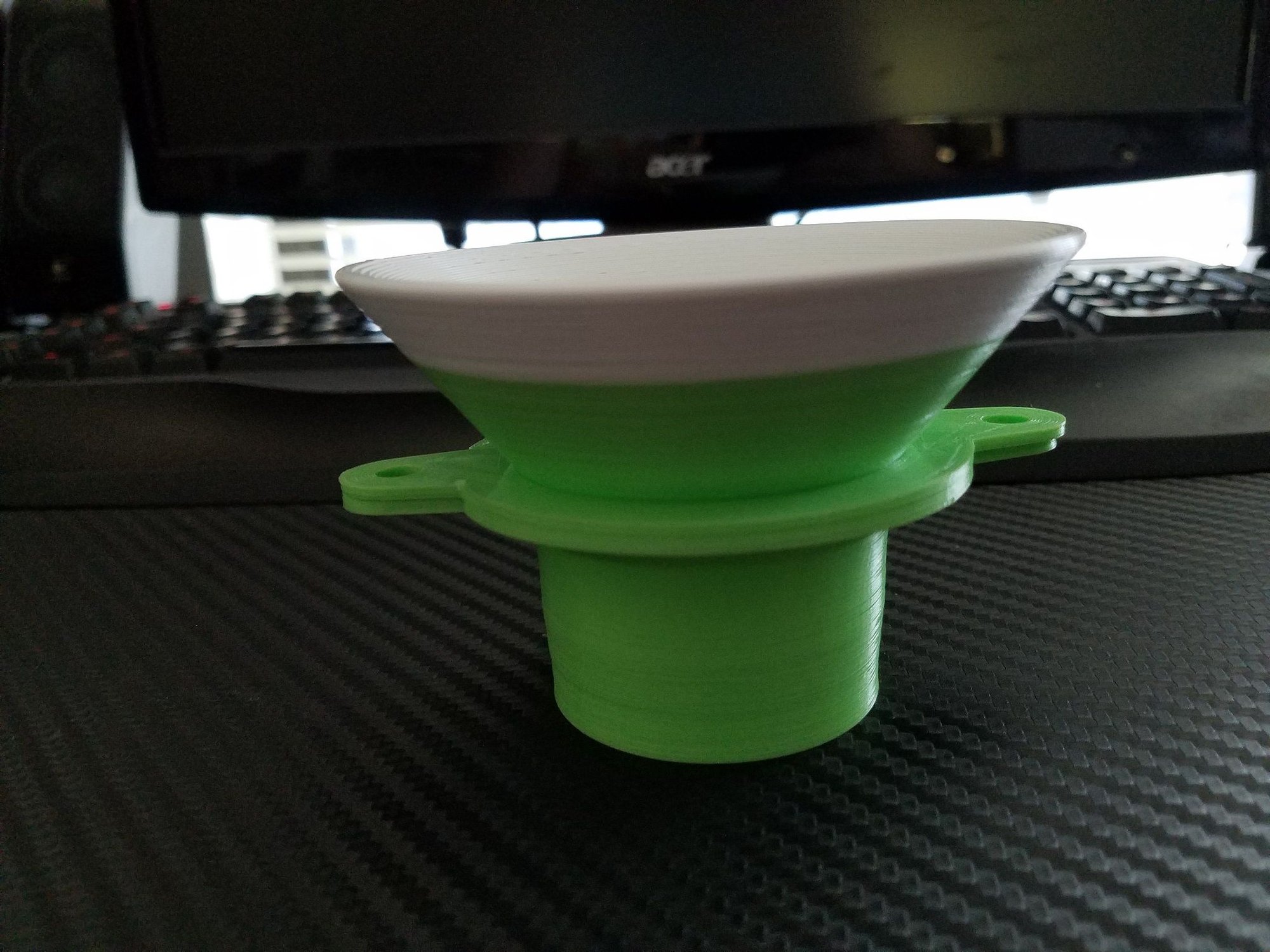

Looks good. I hope I have more time to print something out.
Old Oct 10, 2019 | 06:29 AM
Floyd's Avatar
Joined: Sep 2017
Posts: 197
From: FL
Straight off the printer without sanding or anything. Went with .3mm layers for speed at the moment. Fits together great but I havent tried it on the bike yet. If you want I can send you the STL files to try out yourself.
Old Oct 10, 2019 | 07:46 AM

Looks really good! I'm dying to know how you got the 2-tone colors.
Please send me the STL files, I'll definitely print it out.
