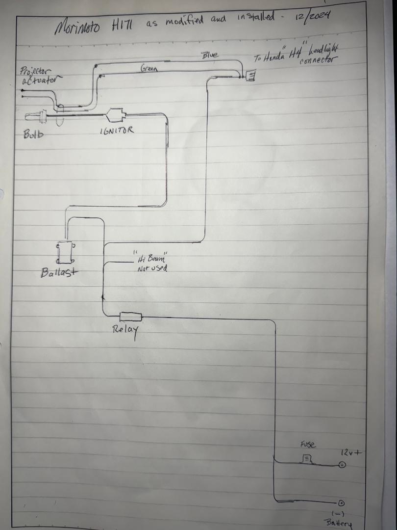

Notice* The "high beam" function of the harness Miromoto provided would not work with my Superhawk. I called them to explain. They have no customer diagram for this harness which made trouble shooting difficult for me . Their representative recommended a Miromoto inline resistor at the H4 plug which they will ship. Not wanting an in-line electric toaster needlessly drawing more current, I found a work around. If I simply run wires parallel from the H4 connector blue and green (high beam and ground) wires, it works perfectly .
At least the harness keeps the low beam on all the time which is what you need with this light. The high beam circuit just activates a shutter which allows full lighting . This way the provided harness "hi beam" plug is abandoned . The bar switch operates the high beam actuator and the hi beam light on the dash still works properly .

Here is a basic diagram showing how I ended up wiring the Morimoto harness.
As mentioned previously, the harness solid state relay as provided would not operate the "high beam" actuator properly. Instead of trying Morimoto's resistor solution , I tied into the harness wiring near the H4 headlight plug to directly energize the actuator.
I cut into the new harness wiring ( For the high beam actuator) and left the original Honda connector unmodified,
