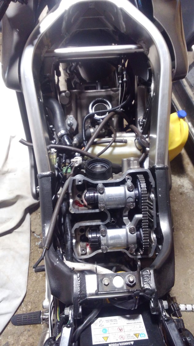

And...here they are.
They are officially installed in the bike. One thing I forgot is that, being a regrind, the clearance changes substantially. So...basically I'm waiting on a new shim kit which has all the shims I am lacking. The new cams end up with a clearance of about .017" to .019" and all my shims are in the 1.7 to 1.95 range so I need quite a jump to make the gap, the least being a 2.05 the greatest being a 2.30 ish. So far the shims have been calculated and the gasket surfaces have been prepped. I reset the TPS while I was at it and double checked my AF screws.
Pro tip # 85694: The night before installation of metal parts, spray them with graphite lube and let it dry. It retains the assembly lube far better than a bare metal surface.
Note* I have a set of RC51 shim buckets that I will be using and upon installation I found the one major difference from the SH lifters. The top of the RC bucket is lower by about ".015, so you will need to re-shim by a large margin if you use them. Combining that with a reground cam creates the need for a fairly thick shim somewhere in the range of 2.70.

Thanks a bunch, my kit cam in today though. I managed to get the rear cams dialed in today and as a testament to Web Cams work, each valve took the same shim, respectively, or should I say, equally larger than the previous with no deviation. Hope fully tomorrow I can get the fronts done, maybe even fired up on Saturday.!!

Holy crap they're finally in, here's the scoop.
Aside from my snafus which led to delays, the install was as simple as any other valve adjustment. The bike starts easy and idles but I have to say it has one hell of a bump now. I thought it sounded good before but holy hell it sounds better than any engine I know of, no bs-in.
Performance: it does not seem to have lost any power down low but it sure revs a lot cleaner to red line and seems to be making power a lot further along.
Driveability: No loss at all. Maybe it's coincidental but a lot of the around town snatchiness has gone away and it purs along at 3500 comfortably now.
I did not use the RC buckets this time around due to a variance in specs on one bucket. I didn't have time to check the lifter bore to verify which one is out so they're back in the box for now. Next month I suspect it will be too cold to enjoy any rides so I suppose I'll park it for the season and start getting ready for the head swap.
One of my snafus was timing the rear cylinder 180 out...turns out you can make a twingle with this engine and it sounds like one mean thumper. It has an interesting power band, kind of smooth and torquey but doesn't rev as high. Sound like a suped up CRF450.
I think a set of adjustable sprockets are in order to take full advantage of the cams, sigh...one more thing on the list. I'll take a short vid with audio and try to post it,
