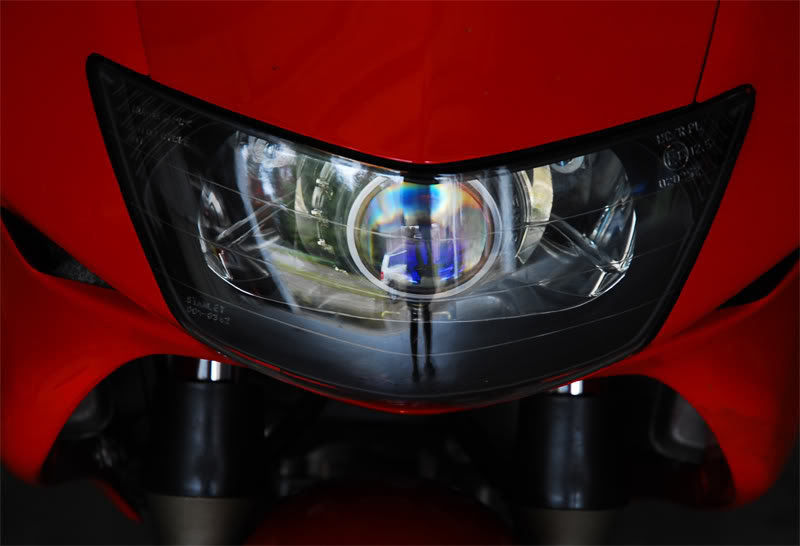

Only time I would run HID in stock housing is if I'm doing it on my dirt bike. I would rather it throw light around in the woods but not on the streets to oncomers.
I made a H4 ring fit on a D2S bulb and tested it when I had my Superhawk before I did the retro. Output was marginally better than stock and I'm sure my focal point was probably better than most aftermarket HID kits have. Yes it was brighter but in the wrong areas.
Doesn't compare to a HID retrofit in performance. As with anything in life, you get what you pay for...
Not to mention a retrofit really helps freshen up the frontend of the hawk...
