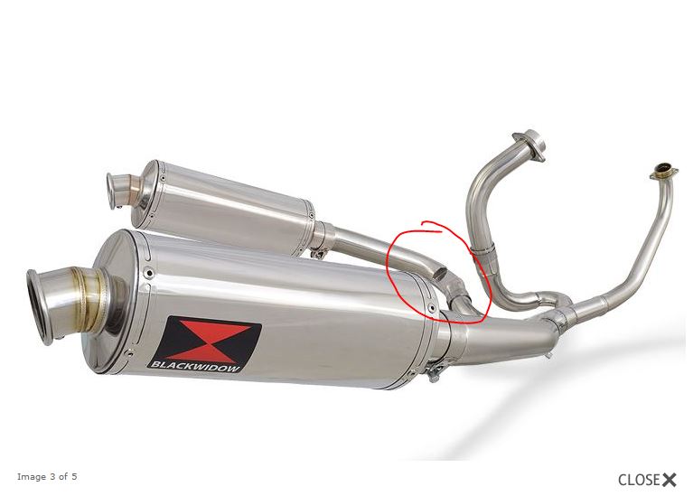

Look at the link pipe for left can
its restricted what look like a full 50%
Old May 24, 2016 | 07:24 PM
Look at the link pipe for left can... its restricted what look like a full 50%
Sure, forget flow, just make 'er pretty! And, is that a stock header?
We have specially designed the left side Link pipe to allow the chain to run over it without touching, some of our competitors do not, so be aware of this.

I thought that was a photoshopping error. Wow.

A 2 to 1.5? Interesting. Have never seen that kind of restriction.

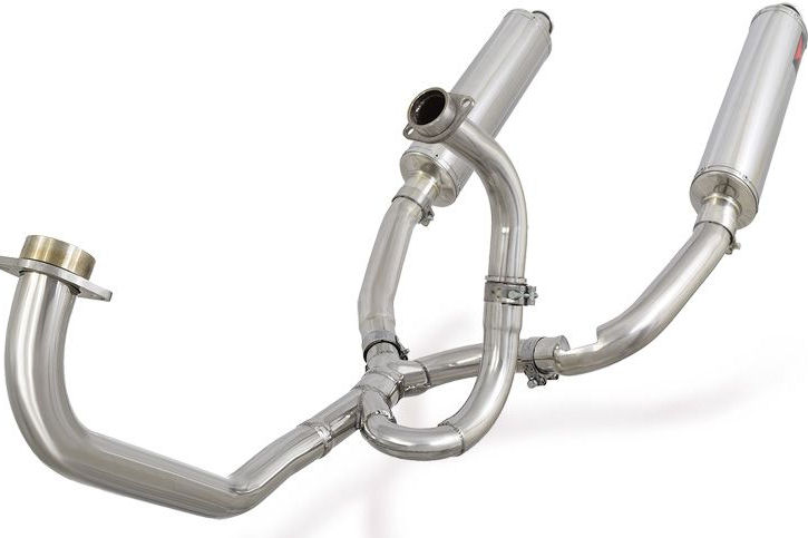

Link pipes... Not looking so good... VTR1000F VTR 1000 F Firestorm SC36 link pipes and 450mm round stainless steel silencers

Looks almost like they copied the design of the stock one and made it from new material.
Old May 25, 2016 | 05:47 PM
Nobody would continue to make and use those stamped bends. Those have to be used headers made to look nice.

I don´t see the reason to buy anyway, seems to be exactly the same design as oem pipes ... Btw, stock left can have this restiction on the link pipe as well, but not this sharp shape.
Old May 26, 2016 | 01:40 AM
A lot of bikes have that restriction in the left link pipe from stock.
My Brothers TL1000S had it.
If these folks made some overbored headers I would be interested.

Here is the response I got from my email inquiry... While I respect their opinion how do they know the flow difference in the link pipes with out putting them on a flow bench, which is highly doubtful seeing they have not even dyno'd the rig...
Hello Bobby,
The notch you mention is for chain clearance, and doesn't affect the performance, in fact the oem Honda headers have more affect on flow than our linkpipes. Unfortunately we don't have any dyno readouts at present.
Regards,
Black Widow Exhausts Ltd

Maybe they too saw the Engine Masters episode with denting the pipes?
Old May 29, 2016 | 02:33 PM
Seen that video, well... most of these dents are more or less flattened, but they made a square cut on that full system, I bet there is some effect to that, same as the OEM restriction, there is a reason to the OEM one as it was tested by Honda for it's existence ;-)
