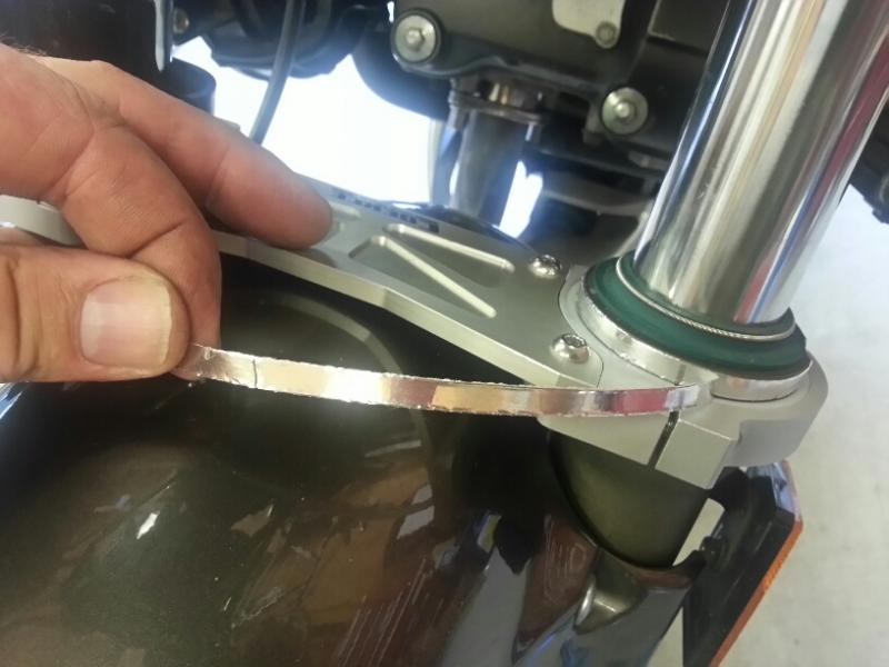

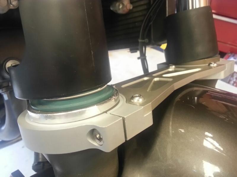

There are probably several ways to accomplish what you want, but here is how I did it recently.
First read 8541Hawk install......
https://www.superhawkforum.com/forum...+brace+install
Next, You will see that after evenly clamping the brace in place, and leaving a gap between the fender and the brace, (I left approx. 3mm), you will only have about 6mm of which to slide the fork protectors back over.
Since the ID of the protectors is slightly tapered, I used foil tape, (Nashua Product) and made two complete wraps around the OD of the Stanchions. This tape has a good "Crush" so you will have a nice tight fit between the protector and the forks.
Since the gap between fender and brace, and the depth of the brace itself has raised the protectors, you will need to cut off about 11-12mm off the top of the protectors to prevent a interference fit when the forks are fully compressed. I just temporarily wrapped several layers of duct tape around the fork to protect it and carefully hacksawed the tops off the protectors, then filed and finally sanded the edges smooth.
That's pretty much it, finished product has been installed for about 2,000 miles with no problems thus far.

Yes, the main use for the Nashua product is HVAC. You could probably use something else, but since I am in the business it was convenient, and it worked just fine.

F Y I for anyone thinking about installing a Coerce fork brace.
Yes, you can retain the stock fork guards after you install the brace and...
Yes, you can install the brace without pulling the fork tubes from the triples (per the manufacturer).
Gently but firmly push the guards up towards the triples. They are held in place by a lip on the guard that seats in a groove on the fork slider. Tape the guards to the bottom triple clamp to keep them out of the way.
Install the brace as close to the top of the fender as possible. You may want to pad the bottom of the brace with a layer of tape to avoid scratching the paint on the fender. Install it loosely at first and tighten each bolt a little at a time to avoid binding the fork. Bounce the front end of the bike to work the suspension a couple times during the bolt tightening process to make sure there is no binding.
Push the fork guards back onto the tops of the sliders as far as they will go. They won't be seated in the same spot as they were before the brace was installed, but the friction should be enough to hold them in place. I tightened a single cable tie near the bottom of each guard to make sure of it. 500 miles since the installation and it's doing fine.

Gotcha. This is why after doing some measuring and sliding my forks all the way up with the fork caps off, I found that at full compression I needed to cut the top of the fork protector off. I mentioned in my earlier reply, this was to prevent a interference fit with the bottom triple.
I think this is the reason most people just remove them altogether.
How you accomplish seating them above the brace may not matter if they are too long, if you know what I mean.
Although nekkid may have found a way to do it that I did not think of.
