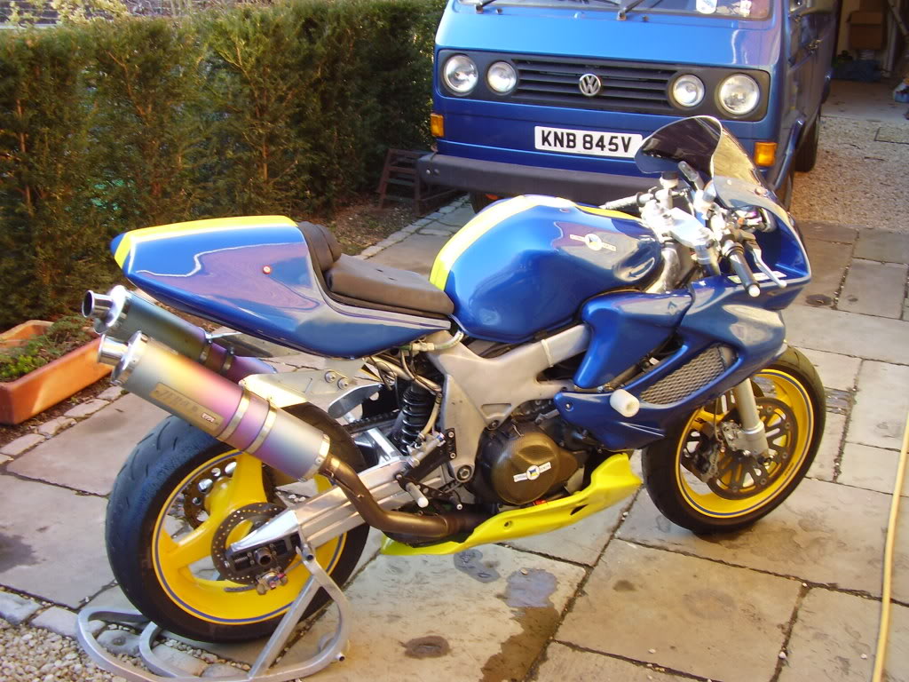

Search for Moriwaki VTR Firestorm Revolution Racing and Roger Ditchfield.
VTR1000F Stage 1A to 3 110 – 150 BHP. A truly great riding experience. The Stage 3 was raced by Mark Ditchfield and “guest” raced by Gus Scott in British Superbikes. This was reported in Performance Bikes as ‘a fantastic ride’. This is truly a great bike.

Wicky....Every time I see the pic of that bike I think...That thing is so sick looking! Tks(Sorry for the slight thread jack)

I know this is off topic, but Wicky, in that first picture, when you zoom in, there is what looks like clear tubing with a valve of sorts running from the tail to under the gas tank. Is there a fuel tank in the tail?
Edit: I just noticed what looks like a fuel filter in the tail in the third picture. Is that what that is?
