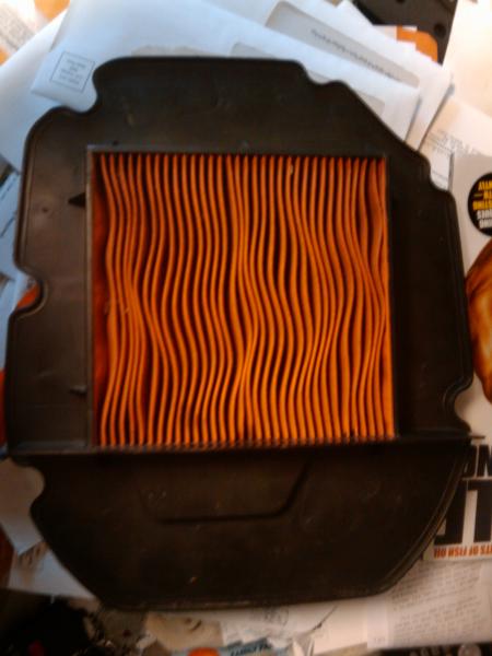

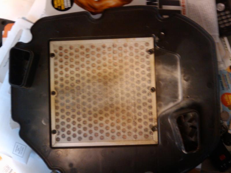

superh1998 May 28, 2011 06:55 AM
2 Attachment(s)
OK,
I took a look at the filter this morning, and I am not sure what type it is.
It is definitely not a K&N (those have separate block offs for the small filters). I don't think it's a BMC filter, but it does have the built in block offs like the BMC.
The only numbers/letters on the filter are "H61 HM-MBB".
I do not have the small foam filters that go in the airbox, since this filter obviously blocked them off.
Maybe someone else can help identify this filter?
Let me know if you still want the airbox/velocity stacks/air filter.
Thanks,
Mike
Attachment 11835
Attachment 11836
8541Hawk May 28, 2011 12:14 PM
MBB in the part number..... Factory Honda part.
You better pick up the small foam filters and install them unless you want to buy a new set of carbs sometime soon..... yes they are that important. ;)
autoteach May 28, 2011 02:10 PM
Agreed Hawk,
They damp the slide movement and not having them leads to premature...needle jet wear. I had to buy a set of carbs due to this (didnt know they deteriorated and disappeared).
superh1998 May 28, 2011 03:03 PM
Thanks guys..I had no idea what it was..this is from a parts bike that I picked up a while ago.
