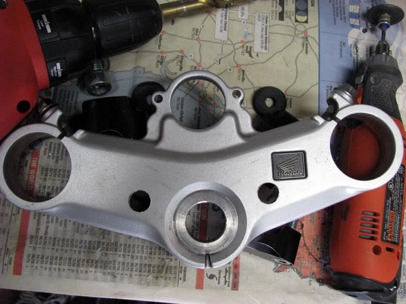

I'm now on my 3rd install on yet another VFR/CBR hybrid project. This particular install will require longer throttle/choke cables but the wiring has plenty of slack.
Attachment 31488
I'm using TAG mounts #4092 (5mm rise) sourced from ebay but any dirtbike oriented place should have them. Just make sure they have a separate bolt that threads into the bottom. Cheap drag bar with small rise also sourced from me-pay.
Attachment 31489
Attachment 31490
Attachment 31491
Attachment 31492
Attachment 31493
Attachment 31494
Attachment 31495
I use a lock washer plus locktite on the threads, it's very, very secure. The bolts thread into the mounts for nearly an inch. It would take for freekin' ever for one to vibrate out. IOW, you'd have plenty of warning of one loosening before it would become dangerous.
BTW, that's a superhawk clutch m/c in the pic. So I gained about 10ft/lbs of torque!!!!
