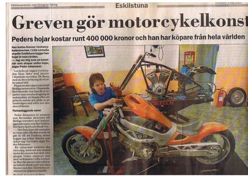

The Kaminari is this bike... Made by Hogtech here in Sweden...

You guessed it. I was looking at the wrong bike. After looking at the one in the pic, I have a lot of questions. Is that ridged frame now? Is it easy to drive ?
Old Jun 7, 2011 | 06:03 AM
I have ridden it...
I bet that was fun!
Old Jun 7, 2011 | 07:33 AM
If we are talking about the Kaminari, no it's not rigid, it has the same basic setup as stock... It's actually the stock frame with the rear top of the frame where the shock mounts have been "filled" with a welded in alu sheet that's brushed to match the cast aluminium to fill it out to match the seatpod...
I believe, but cant say for sure, it's a shorter than stock shock, and i know for a fact that it's the stock swingarm that's been stretched a bit with a new set of axle mounts and a bling-bling chainguard...
Basically he re-used as much as possible of the stock parts, it's a "budget build" in that sense, but obviously done by a pro builder with access to a range of tools that most of us just dream about...
