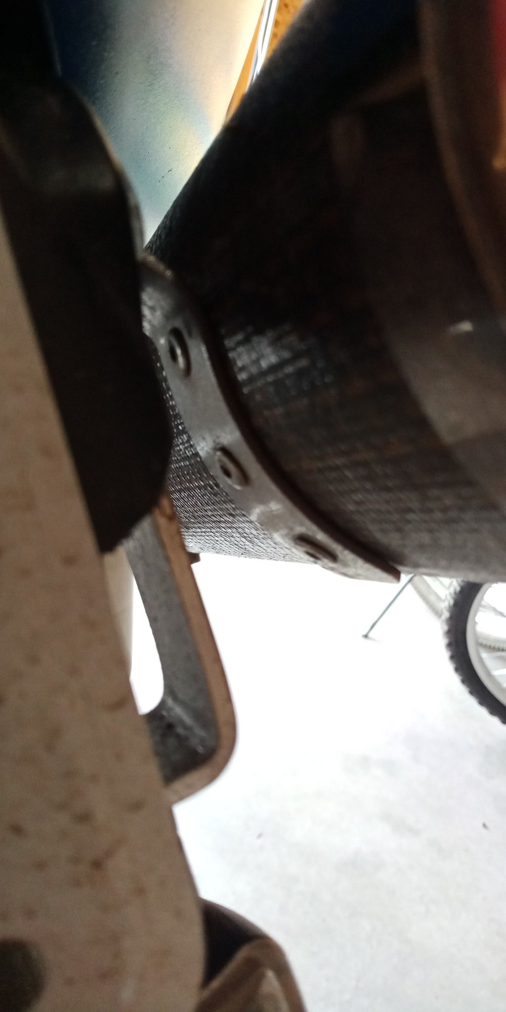

The previous owner had done that little mod with the exhaust and had put about 5k miles with them hanging that way, plus my almost 1000 miles, and they are still solid....but there is a first time for everything (to fall off 😂 )
They do have brackets for them (homemade I believe) and couldn't figure out how they hang from the passenger pegs. There didn't seem to be enough room to wiggle the right side exhaust to get it down far enough, and the brackets don't seem to line up on either side without needing an extra 4" long strap to connect the pegs and muffler mount. The left side will go low enough but that's where the extra 4" long strap that would be needed.....or is there something I'm missing?

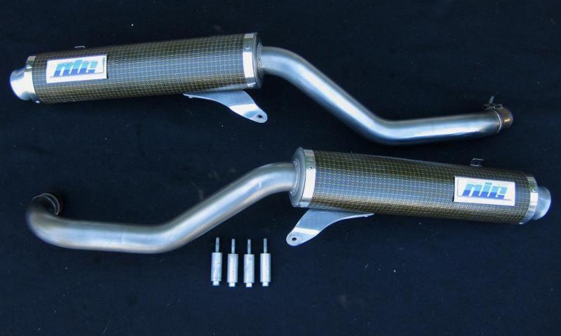

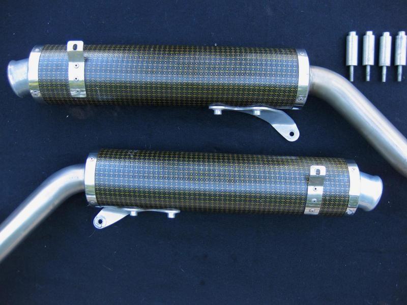

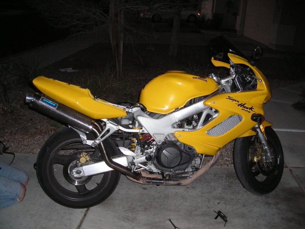

This is what you're supposed to have-a forum member's bike and a pair I sold awhile back...

I have those brackets for the bottom, and that top bracket must be what the previous owner used to do the current mounting job. The bottom brackets were spray painted black and the paint is chipping, so I figured they were homemade.
So how do the rear pegs mount around the exhaust? I would assume there is a spacer that I don't have?

Correct. Most (not all) brands of high mounts came with longer bolts and spacers to move the pegs out enough to clear the mufflers. It's probably about 2". I believe the bolts are socket head M8 X 1.25 and the length varies with the brand. I believe Jardines were 70mm and some others 90mm. The bolts are easy enough to find. Hardware stores won't have them long enough so I remember finding them on Ebay. The spacers are probably a lot harder to find without having to make your own. If you want to mock everything up and measure the space between the passenger peg and subframe I'll see what I have, I think I still have a few sets of these I hoarded over the years...
You can see the bolts and spacers in the 2nd and 3rd pics I posted
