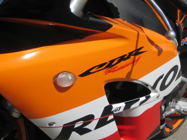

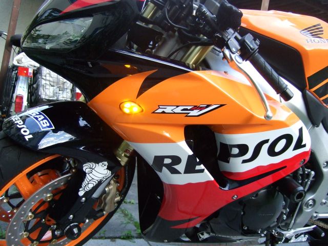

I've searched and searched for info concerning Protons AND Watsens flushmounts. Only to come to the conclusion that I totally like both of em. Protons are programmable.....Watsens have that cool 3-LED config. So, what do you guys think looks cooler....the Watsens in the left pic or the Protons on the right?
Anyone with experiences with either?
Any install tips?
Attached Thumbnails Proton or Watsen Flushmount!?!?!?!-1350926957_15510eac57_o.jpg   Proton or Watsen Flushmount!?!?!?!-26211_protons_honda.jpg

I was kinda on the fence, but after seeing the pics, I vote Watsen. Looks cleaner.

Watsen look cleaner but I think Protons would be brighter. I also like the strobe, normal flash, and fade + running lights you can do with the Protons.
My vote would be Protons based on the fact they are cheaper and might be more effective.

The Watsens do look awesome. But I like the options on the Protons.
