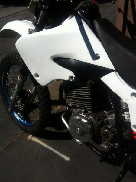

I plastidipped my xr600 plastics last month. I don't like the stuff. The nozzle on the spray can gets clogged up, and sprays an inconsistant stream. I used three cans for three coats. It's a bit porous, if you touch with a greasy finger, good luck getting it off. Those are my gripes, I'll be peeling it off and going gloss black for all the plastic. I attached a couple images of the white plastidip after applied to my bike. I think I'm a pretty good "spray painter" but this stuff was not as friendly as paint.
The grease is really tough on the paint. At least with white it isn't as obvious. Black is just about the worst one to have grease marks on because it looks like spots.
