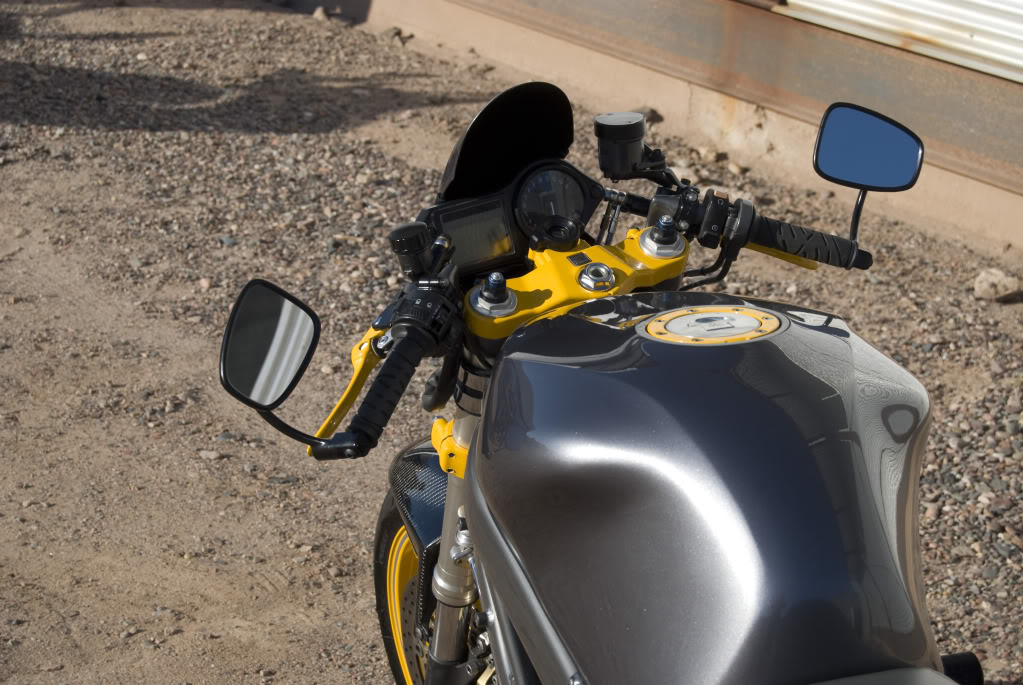

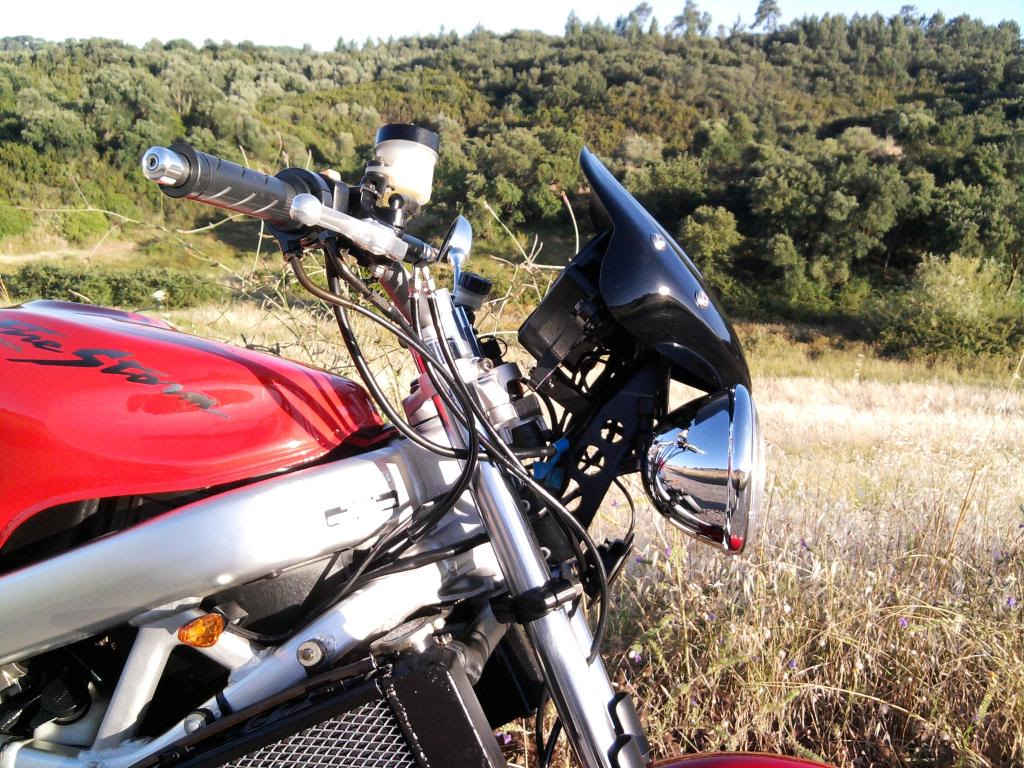

People have run a few different setups...
You can fairly easily swap guages with one of the newer CBR clusters, which are much smaller and gives you more room to work with (also, more waterproof). Most of the wires are the same, you just have to match them up.
Like this:
You can build a housing around the stock gauges which cleans them up pretty well, like pappy did in his recent build:
Or this one, which was swappable to stock if I remember right:
You are probably going to want to somehow re-mount the stock gauges, though, because they sit way out there without fairings on.

Well those last two use the stock gauges, but just mount them closer to the forks. The red one still uses the fairing mounting bolts on the frame, which means that when you turn the handle bars, the lights/gauges still point straight.
Pappy mounted his gauges to the forks, so they turn when he does.
If you're worried about mileage then definitely keep the stock ones. IMO mileage for bikes this old doesn't play too much of a buying factor... because it gives no indication as to how the bike was ridden or taken care of. I know that doesn't help you much re-selling it, but just throwing it out there.
BTW, re-selling bikes that are converted naked is usually just as hard as ones with mileage discrepancies
