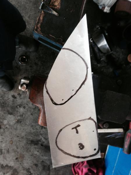

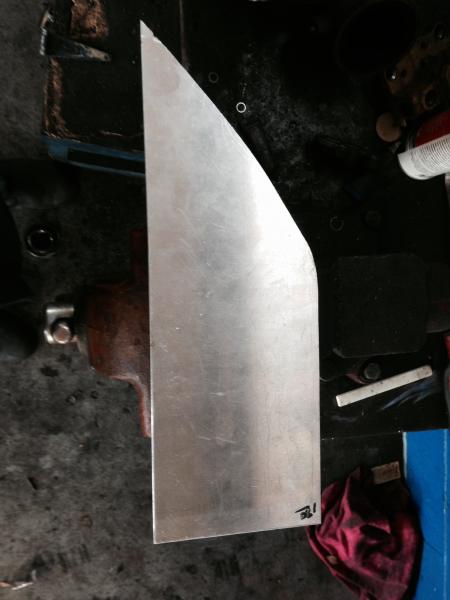

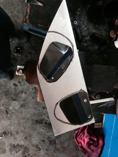

So since I broke a heel guard on the DanMoto rear sets, I figured I would make my own. I am using 1/8inch 6061 alumminum plate.

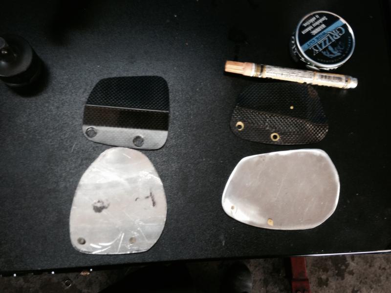

All cuts are done by hand with high speed grinder.
As you can see I made them slightly larger than stock.
The plan is to mach them up the way they are tonight and if they look good, I will smooth them out, clean up the edges and probably drill large holes in them so they have some kind of style to them.

But when I was drawing it up they didnt look right with the rear sets, and I couldn't see away I could make them sit right and still look like they belonged on the rear set. So for this first run I decided to use the Danmoto design but make them a little larger.
One thing is for sure, I will not be bending these new ones with the pressure of my heel. This AL is stout!

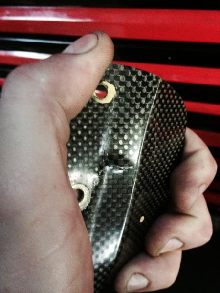

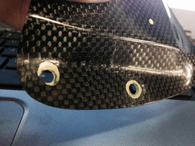

The problem with the Carbon Fiber is its too flimsy, even with the bends in it. The flex wayyy too much. If you look closely you can see I broke the left side with my heel while turning, which is why I choose AL for the job this time.
It's really sketchy to come into a turn and hear a pop and all the sudden your foot and "heel guard" is skipping off the chain.
Here are some pictures of the broken "heel guard"

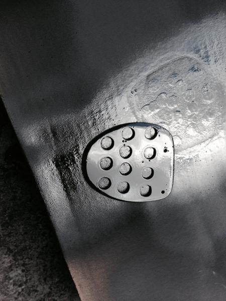

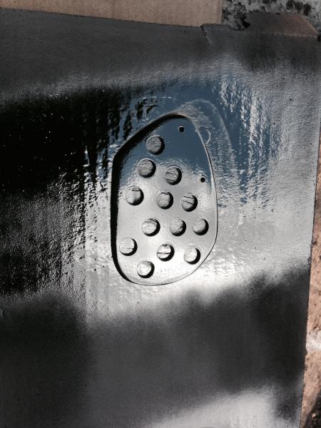

Ok, So here is the finished product.
I know I screwed the holes up a little bit so they aren't perfect, but still 100x better than the crappy carbon ones.
Still at work so I havent had the chance to check to see how they look on the bike once I do I will post more pictures.

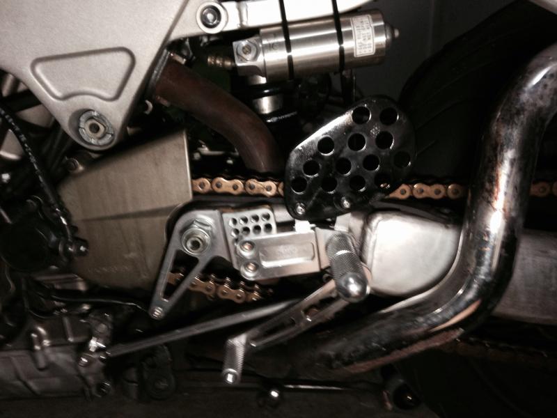

home made Danmoto heel guard's-image.jpg Click image for larger version
Installed. I think they look good. Now going to strip them down and powder coat them.

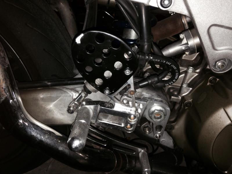

Old Apr 16, 2014 | 05:31 PM
sailorjerry's Avatar
Joined: Oct 2012
Posts: 501
From: Orlando, FL
