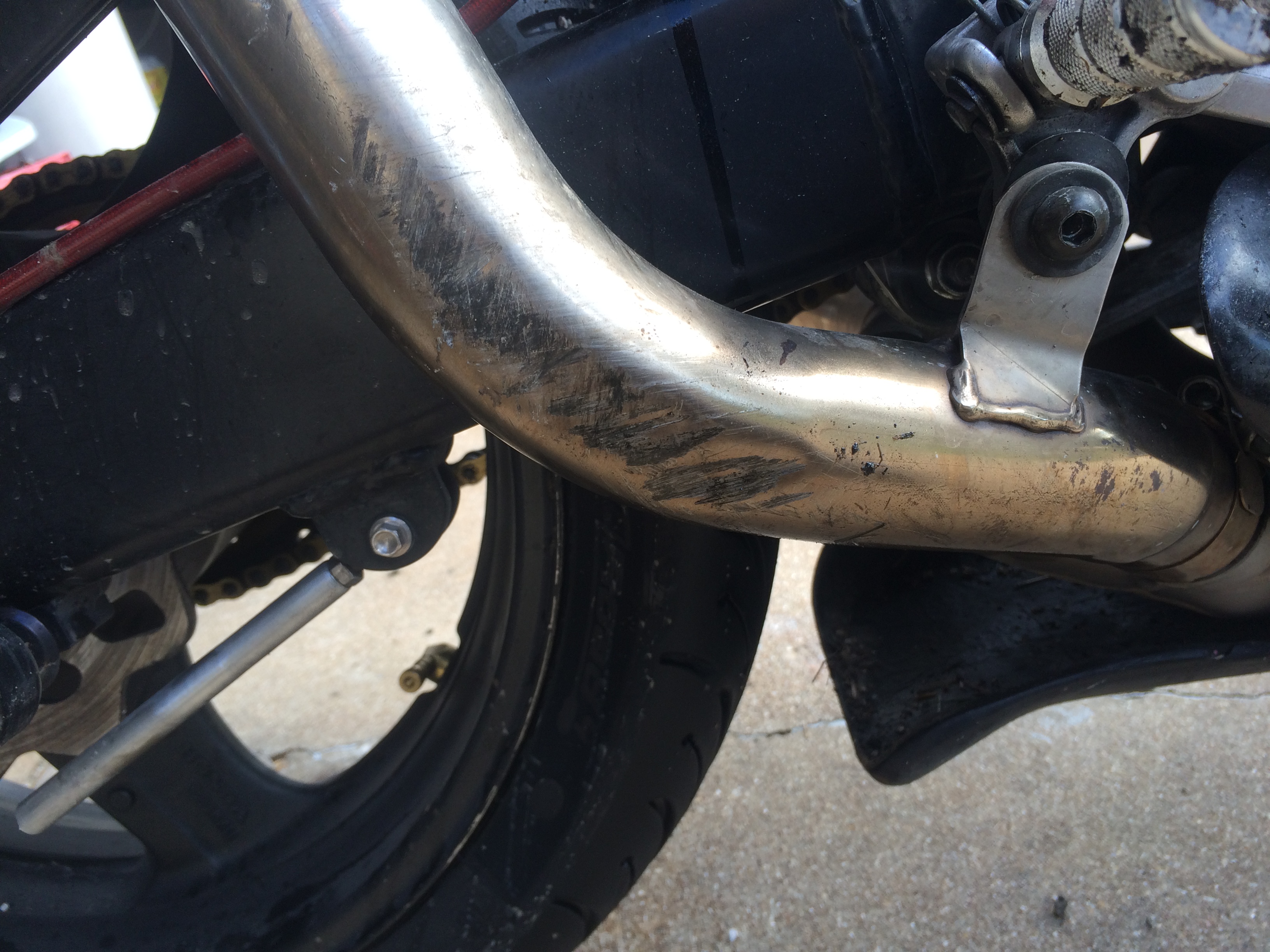

So I have a Leo Vince carbon exhaust that took some hits in my crash..
Anyone know where you can source and purchase those metal bands?
Or of a shop that would repair, or replicate that mid pipe?
I've written to Pipe repair and Fusion USA in the US and MHP in the UK.. No response yet

Erik, when I cleaned my Yoshies, I replaced those bands. Give me the diameter of the pipe, and I'll let you know if they compare.
I think I may also have a spare.
Old Mar 5, 2016 | 08:39 PM
Jack, thanks
Diameter is 346mm with rivet hole spacing of 58mm
Of note Leo Vince USA returned my email.... and said, sorry, not in production no parts available.
Of note 2; Fusion One Fusion One Home of the $60 Pipe Repair returned a contact form... and made a very reasonable offer to repair the mid pipe... the will remove the dent, weld up the scratches and grind/sand/ buff the pipe back to respectable condition.

Sorry Erik, rivet hole spacing is 45mm. You would need to drill new holes, and some of the old ones would probably show up in the openings.
Old Mar 6, 2016 | 02:29 PM
Thanks////\\\\\
Im thinking I'll use a piece of 10mm wide solid strip of stainless steel ...and drill the rivet holes where needed.

I have used the freezing and heat with air pressure on thin wall off road pies for years, and had results from good to what the hell happened,
On the heavery wall street bike pipes the results are less good... Im sure I could get it to work,,,,but if I screw it up, the pipe is not replaceable.
Next is, even if I get the dent out, I don't currently have a way to TIG stainless steel... That is how you fix the scratches, weld filler in, grind/sand/polish
Fusion has agreed to take on the project for reasonable cost..
And a place in the UK is interested in repairing both the mid pipe and the can.
However, a fellow SH forum member has just told me he can duplicate the band if I send it to him... With that piece of the puzzle figured out Im all set.
Fusion will repair the mid pipe
Marquez racing will repair the can with some help from a friend.
And then i can swap the low mount Yoshimura pipes on the SH now and get my nice Carbon High Mounts back on.
