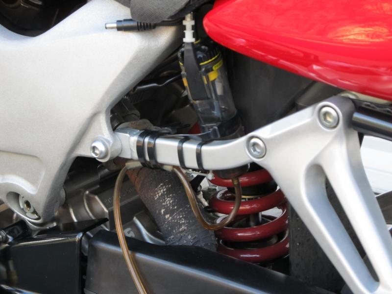

Were you on Greg's old runlevelzero.net forum? I went to the 08 Indy washout to. What a disaster trying to get north to Skokie, it took me 12 hours of detours through water up over my knees.
BTW, I put my Penske reservoir on the right side as far from the rear header as possible. Too bad about the cane. I know pain due to a bicyclist taking me out on my pedal-bike causing 2 ruptured disks btwn C4 & C6 + a torn rotator cuff & other assorted injuries. Still have pain, burning, tingling & numbness in my left shoulder & down my arm. Now they want to fuse them. I've tried helibars,"tubulars" & now the Tommaselli's, lowered & raised & re-contoured the Sargent foam 4 times, added lower Vario pegs, and still take Motrin like candy & & have to stop more often than my but needs. In cold weather the heated grips help some.
