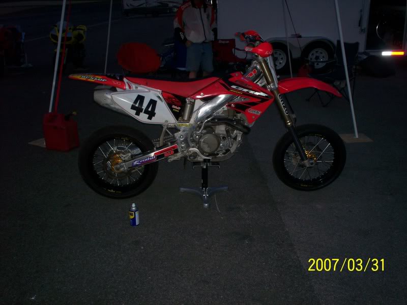

Good thing you are dropping to a 150 or a 160 as the chain will eat the heck out of the wheel and tire on a 180 and probably on a 150.
I am running a 160 on my CRF450, but i have a spoke wheel and moved the rim to the right about a 1/4" to give me some more space for the chain.
CRF450R is about 230 at 55HP and has 12:1 piston stock.
I am seriously thinking about picking up an XR650 and tarding it.
Old Track Day Pic at night

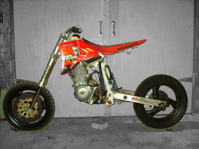

the srx motor will put the chain about an 1/8 or a little more off center than stock. I really doubt the chain will rub the 4.5 inch rear rim but i could care less if it grooves the tire. Ill also have to make an adapter for the sprocket as im eliminating cush drive.

looks great!
What supports the subframe? Or rather, what is it attached to other than the two bolts at the front?

Posts: 1,033
nothing at the moment
