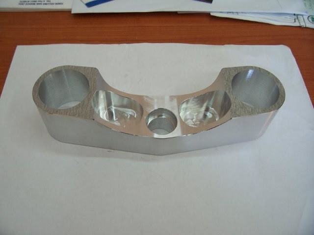

Nice work on that clamp.
Not that I need one, but how much might you sell that piece for ?

For a couple of triplee clamps "at measure" the cost is near 350/400€... but this is a forced choice, because the offset of the Brembo racing brake disks was greater than the original, so I have to increase the distance of the fork legs.

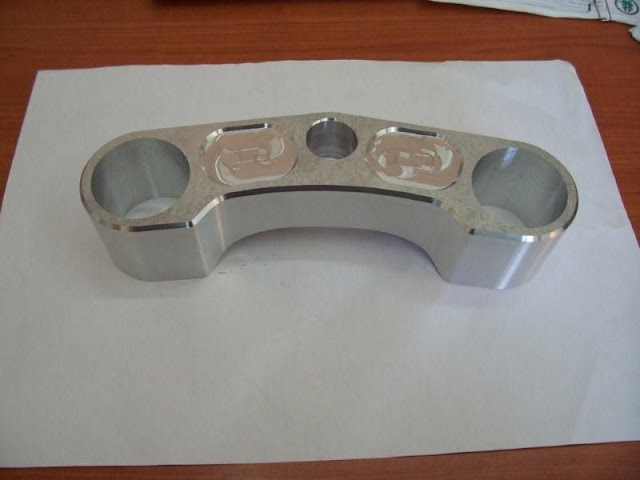

Other pict... now i have only to spray the transparent pain on this parts of fairing...
And a update of the triplee clamp... this is the lower, to finish, but...

Toootally impressing. you have awsome skills really!
Are you going to anodize the clamps yourself? Im playing around with that aswell. And i cant make the colors stick to the things im trying to anodize. If youre doing it youself. Maybe you could help us out with an anodizing" how to" one Day?..
Keep the pictures coming...

No, i don't want to risk my new clamps whit "did it yourself" anodization...
I'm sorry!

nice project! are you making the clamps with the stock offset of 35mm? sorry couldn't read the numbers in the picture.
Originally Posted by Rama
Yes, but I would to change whit the ohlins in one of the latest photos...
I hav'nt solve my electrical problems, but today I have finish the project of my triple clamps... this is a picture of my project, and they will be made "on measure" in ergal 7075 T6.

No, the offset in the pics was 35, but finally i decided to go whit 30mm...
