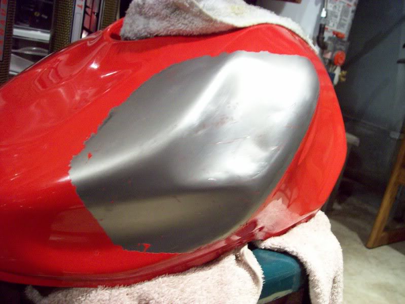

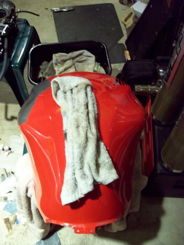

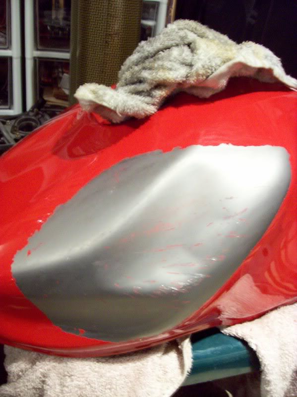

Well as many of you know I wrecked about a month ago and I figure now is the time to start getting after it. My first order of business is going to be the tank and trying to take the dent out and pretty it up the best that I can. I am thinking some kind of black metal flake...maybe
The dent

Now I am going to try and weld a stud on to the outside of the tank and pull the dent out the best that I can then do body filler from there.

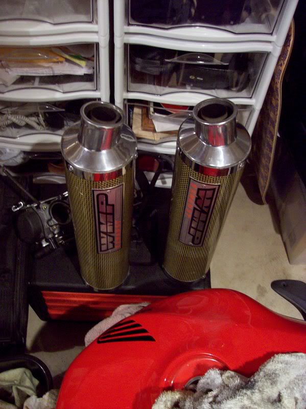

I received some carbon kevlar WMP's from Calitoz and polished them up nice. The only problem is the more I look at the bike the more I want to fashion on a shorty GP style M4 slip on that would normally go on a gix600 or an r6. So I am torn and might let the pipes go. I just like kustom stuff.

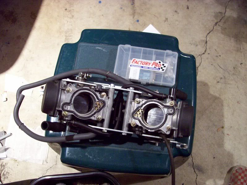

I also have a factory jet kit that will be going in...indeed

Crash damage Tank and Fairing Repair
Scumbag - don't drill and pull the tank dent. Take my advice, I'm repairing similar crash damage as we speak. Get fiberglass body filler (not bondo/polyester based crap) easy to work with; excellent adhesion, shapes well, very durable - sand/shape until only very minor surface imperfections or scratches remain and fill those in with 3M Acryl Green - comes in a tube from auto body supply shops, spreads with your fingers like a real thick paint base to fill in minor visible defects. Follow directions re: sandpapering and prime. Be patient, sand slowly while eyballing everything and gradually work your way from 220 grit on the Acryl Green base to a 2000 grit wet sanding on your final coat of paint, you'll be surprised how good it turns out. make sure you rub out with light pressure on rubbing compound, then polishing compound, (wash painted surface between each step) then final buff with carnuba wax and you should have a nice finish if you used quality paint.

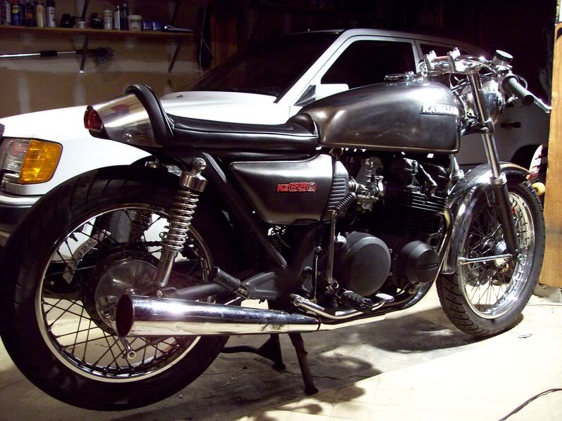

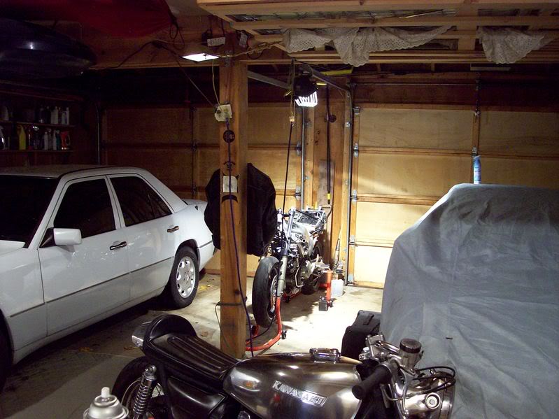

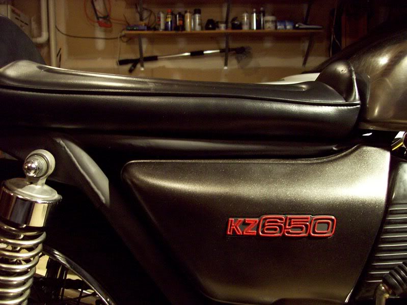

oh and here are some pics of the cafe
I have a diffrent exhaust for it but it needs welding...

Posts: 4,517
That is too cool! Awesome!

That is sweet! I miss the old KZ's, CB's and XJ's.
If I only had more room in the garage........

I used a stud gun to pull dents out of my tank. A good way to evacuate gas fumes from tank is to remove gas cap and sending unit on bottom of tank. Attach a wet / dry vac. on blow to the gas cap area. Tape it in place with duct tape. Turn it on and let it blow for about 45 minutes or so. Tank will be dry and fumes should be gone.
