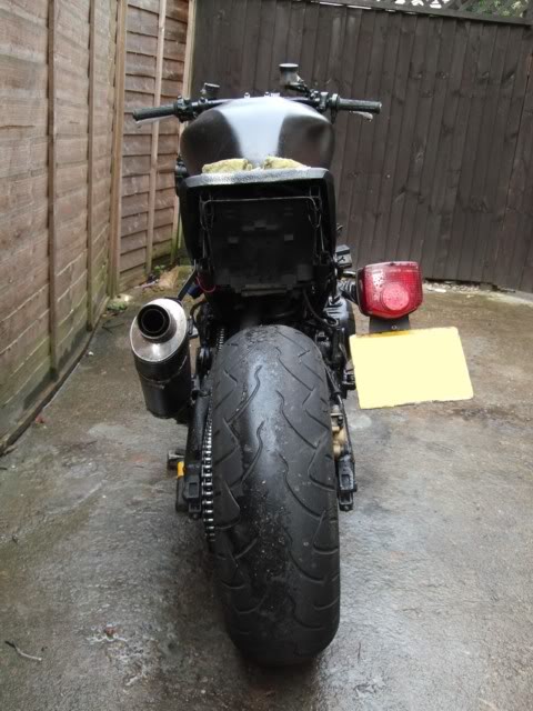

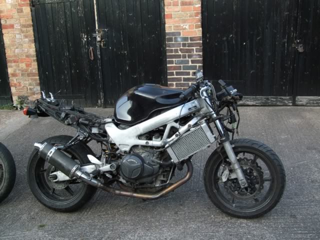

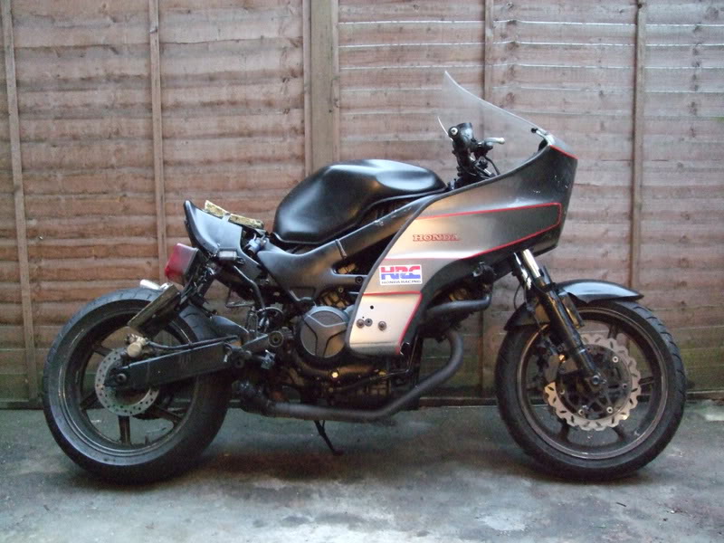

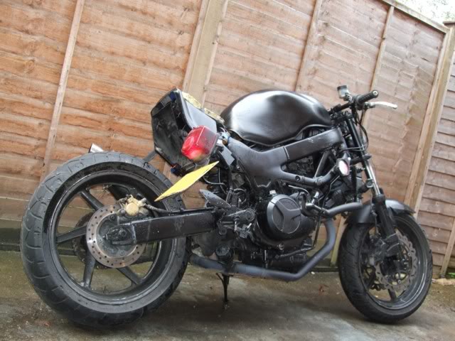

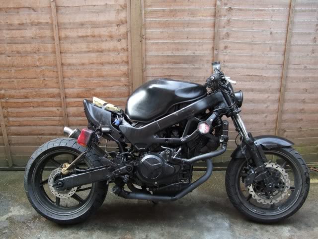

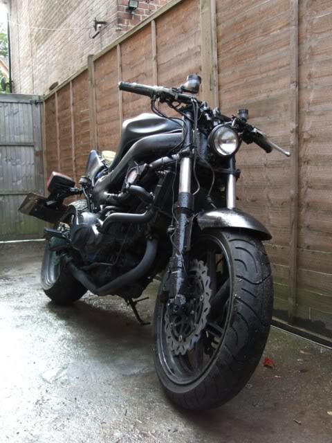

I got it cheap as it had been down a ditch, I don't like spending money and needed a bike to ride to a rally 150 miles away so I set-to and fixed it in 3 days using only stuff I had laying around in the shed/garden.
Bike features a CB250 rear lamp and a mini bates headlamp (which sucks), new seat made from the tail plastic from a CB250 rs widened with some tin plate and padded with a bit of sponge mounted on a cutdown rear subframe.
Monday at 4pm

CUSTOM PARTS:

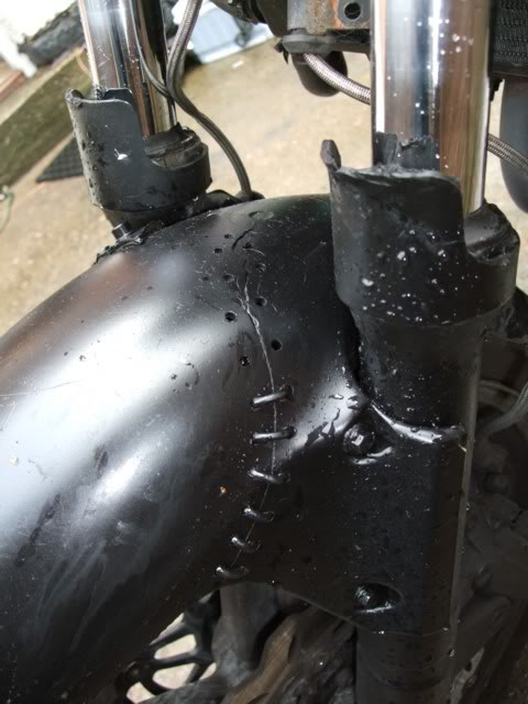

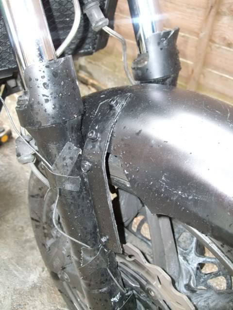

Repaired front mudguard that was smashed to bits with some aluminium plate:
And 'stiched' with wire:

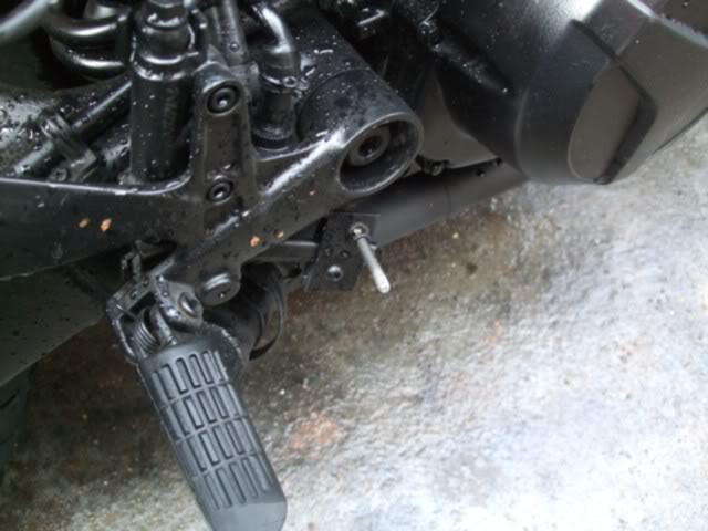

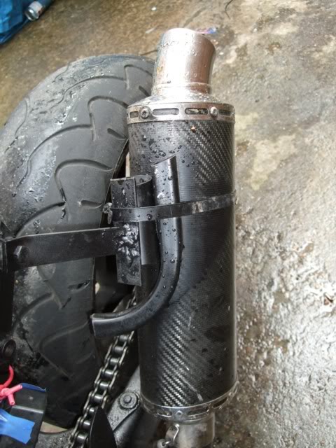

Custom 'spacers' added to take up the slack in the circlip that holds the exhaust on:

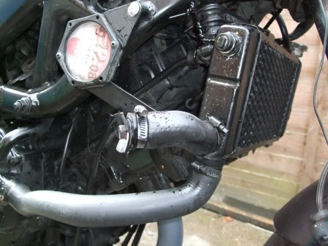

Secondary radiator feed blocked off with a 17mm socket and a bolt, bolt leaked like hell so I made a washer from an old bit of innertube. Oil cooler moved to higher position and secured in place with some old wire. New radiator mounts made from a strip of metal laying in the garden:

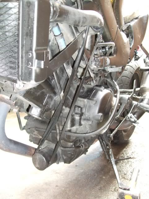

Airlock removed from rad pipe using tape to pull it lower:

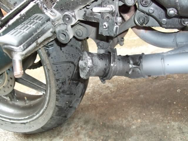

Secondary exhaust pipe capped with a washer and a bit of an old bicycle frame:

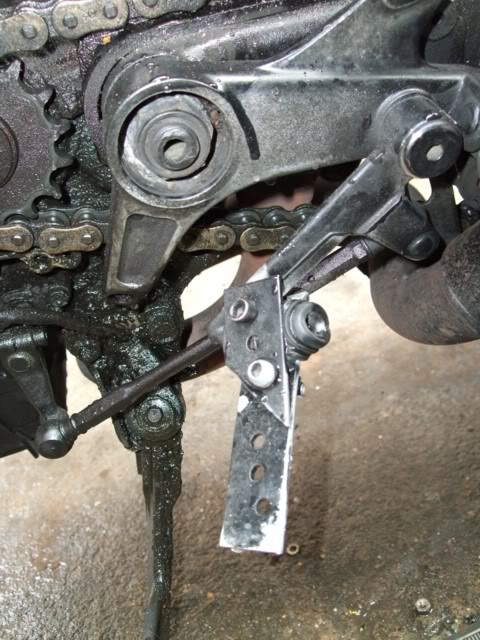

Broken brake lever fixed with two bits of plate and a couple of bolts:
Bent gear lever repaired in similar manner:
Back from the dead.
oooo nearly forgot, had this fairing laying about for a while, might well end up on it if I can be arsed to fit it.

HOW (EXACTLY) DID YOU HANG THE FRONT RADIATOR AND WHAT KIND OF RADIATOR IS IT??
Good job.
Tom
Thanks, the rad is just the normal one from the right hand side (you can see it in it's old position in the first pic) it's mounted with a couple of bits of flat bar bolted to the frame (it's plenty solid)
