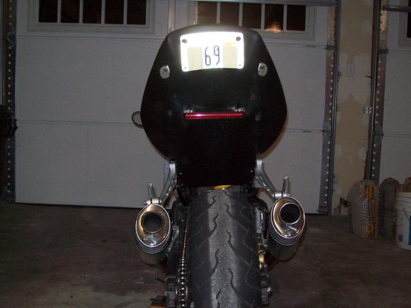

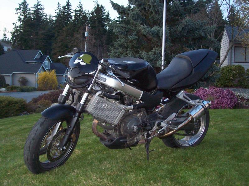

my never ending project. 520 chain conversion +1 in the rear , viper race cans, K&N filter, raised subframe, custom fiberglass job on the rear, stealth flush mount blinkers mounted on the inside of the radiators.

looking good. I like the raised tail and shorty cans.
My suggestion, move the damn radiators and show off that beautiful engine.
Old Apr 9, 2009 | 12:13 PM
Malice's Avatar
Posts: 158
I like the front lights. Can you show a side shot of the raised tail?

looks mean. i love it.

thats mean! i agree bout raising exhaust or j/ put it on very bottom

bet its crazy loud!
Old Apr 9, 2009 | 09:25 PM
My ears are hurting just looking at those cans.
Looks like the top of the tank is bashed in. Do you stunt? (sit on the tank wheelies?)

I like it. Trucs right move the radiators... Also ditch the acerbis, it's a bit played out. Make somethin cool! Nice bike though man.
working on stunting but nothing crazy dont have a engine cage yet

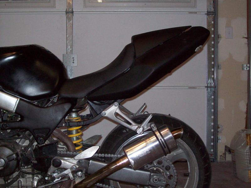

more pics
dont know how to add more pics to the top article so heres more from the side and rear.

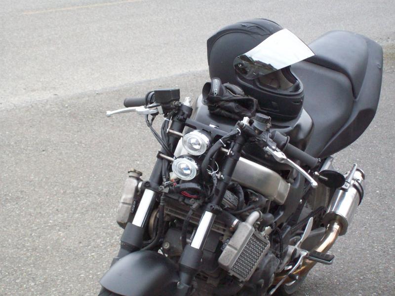

head light test fit

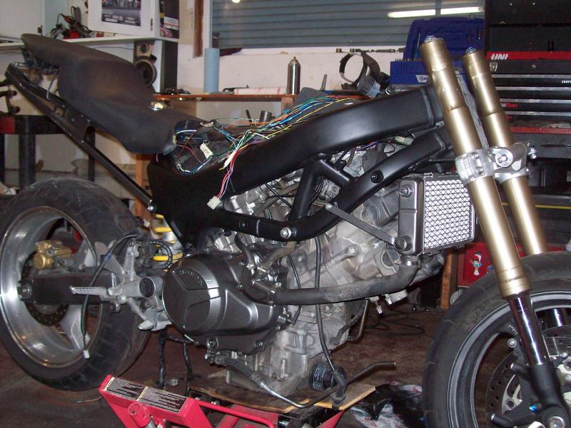

start of the new build

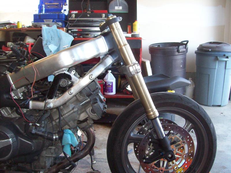

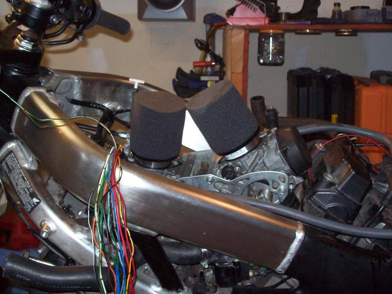

installed pod filters vs the air box the bike will run just fine when i get done jetting fighterhawk-008.jpg

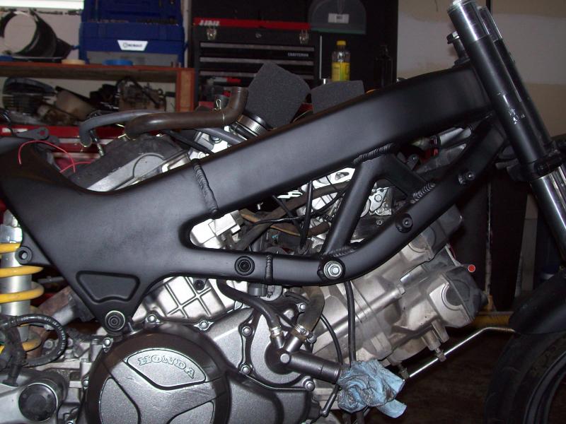

removed the stock radiator overflow tank going to make a custom one and moved the coils from subframe and side of frame and installed them on top of each other underneath the carbs.moved the wiring harrness from under teh side of the frame to the inside the frame. so you cant see it.moved the oil cooler lower down so a single radiator can be mounted in its stock location.going to rebuild the subrame to make it sleeker looking.

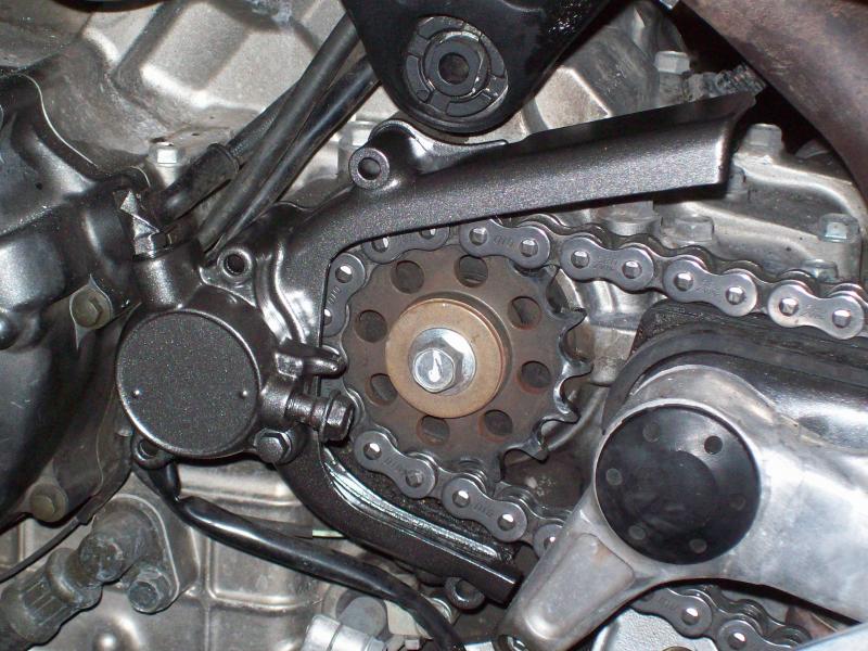

cut down the front sprocket cover. just love to look at the 520 chainfighterhawk-froks-005.jpg
Old Jul 5, 2009 | 10:16 PM
Truckinduc's Avatar
Posts: 1,033
when I cut mine down, I saved the dust from the saw and made a pile and lit it on fire. Got to love the way magnesium burns

I'm curious to see how the pod filters work out for you. Everyone here is too scared to even use a k&n lol

well i've seen some guys in here running k&n with no lids so i think thats basically the same thing

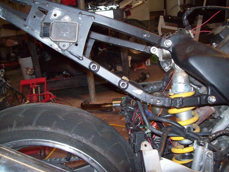

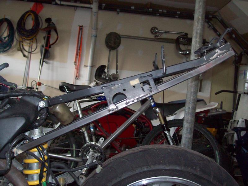

i raised the tail to give it a more aggressive look on the last go around but found it was a bad idea if you have the old lady ride with you . so cut a new peice to be put in. hated looking at the old brace hang down so much so i ended up with this.

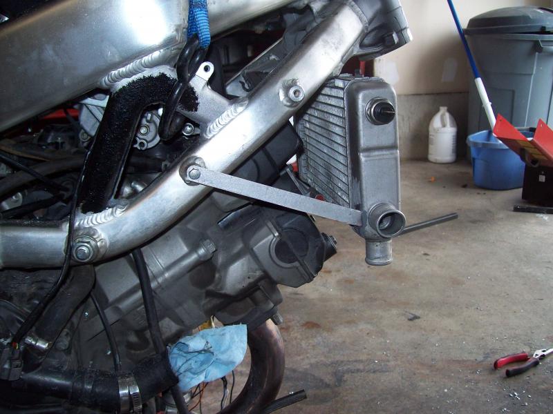

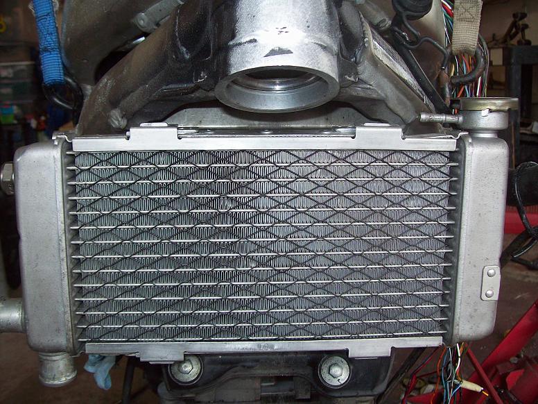

made the mounts for the single radiator upfront. didnt get to envolved with the build because im going to get a CBR radiator later to give it a more complete look. used the old holes from the oil cooler for the top bracket and the old side radifighterhawk-radiator-004.jpg
fighterhawk-radiator-006.jpgator hole for the bottom bracket

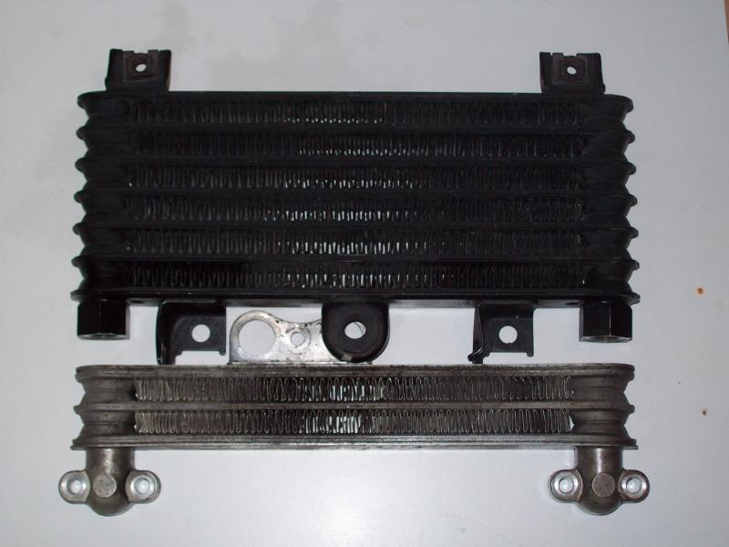

found the oil cooler i bought for the ZX6 build im very slowly doing going to use it vs the stock VTR's this one is twice as big. doesnt hurt to run cooler. will post a pic when its finally mounted.

oil cooler replacement
heres a pic of the replacement zx6 oil cooler im going to use in place of the stock onefighterhawk-oil-cooler-004.jpg

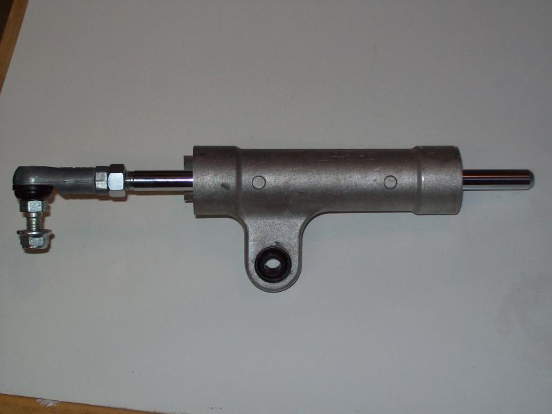

also finally got the steering damper for the GSXR forks going to work on mount to the frame this weekend.fighterhawk-oil-cooler-005.jpg

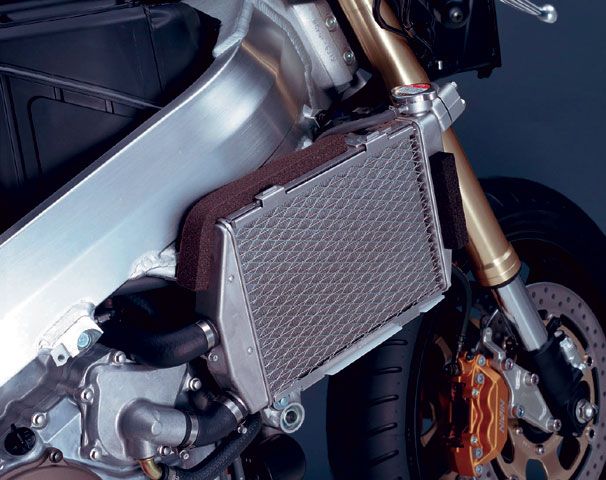

Great job,all looks good.I like the black/silver color.I wonder how a rc51 radiator would fit up front,its a little bit bigger but might help with cooling.Keep up the great work.What year zx6 oil cooler is that?
